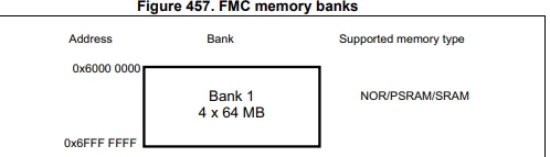

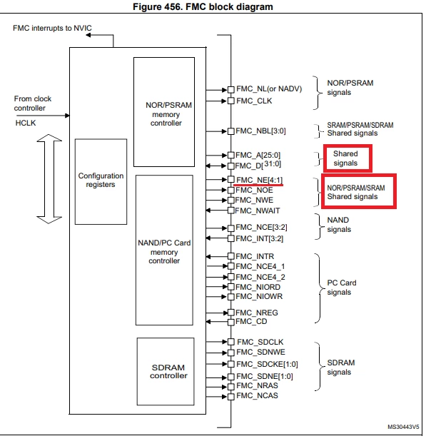

You will be using the same Address/Data/ NOE/NWE pins and you need to drive your SRAM with another chip enable. The chip enable FMC_NE is driven according to the access address :
BANK1 (256MB) needs to be used which in turn split into 4x64MB. Each access to a block of 64MB will activate the corresponding FMC_NEx pin FMC_NE1 to FMC_NE4.
Hope I answered your question.

Thank you, so FMC_NEX works in parallel with another enable?
Each enable is activated at a time. FMC_NEx is activated automatically by the FMC controller according to the description I provided previously.

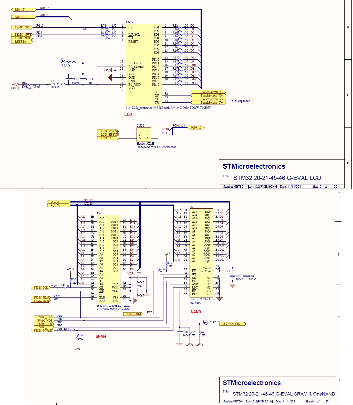

As example, you can refer to the STM3240G-EVAL board schematics which is using LCD and SRAM that both are connected on FMC interface:
