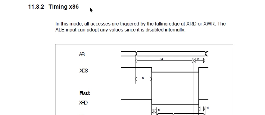

FMC: How to delay chip select?
I should combine STM32F479 with PROFIBUS-DP ASIC SCP4-2
The chip is aged. And requires delay of at least 30ns (by 3v3) between address and cs. Our previous design was based on SAM4S and their CPUs are offerring register to program such delays. In STM32F4 reference all the pictures suggesting that cs is always phase synchronous to AB change.
Did I overlooked something? How to deal with this?
