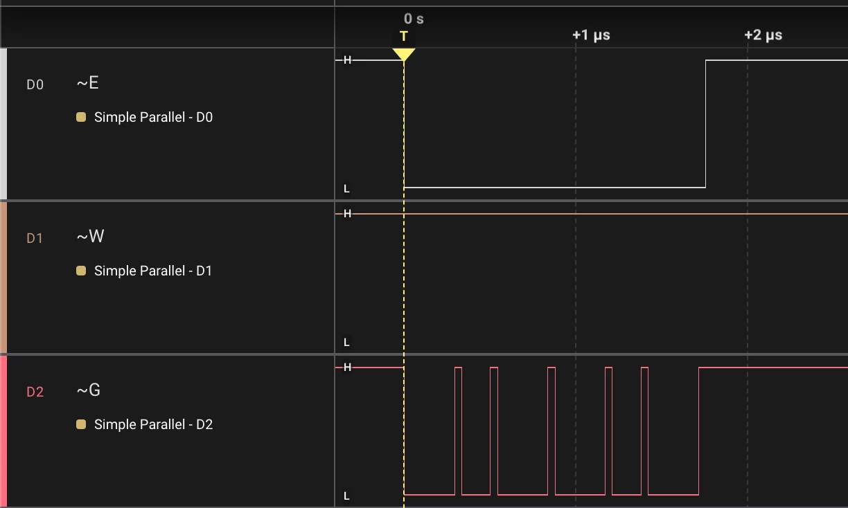

1. in my example, HAL_SRAM_Read_16b works correctly. ~E and ~G are triggered, and data is read correctly.

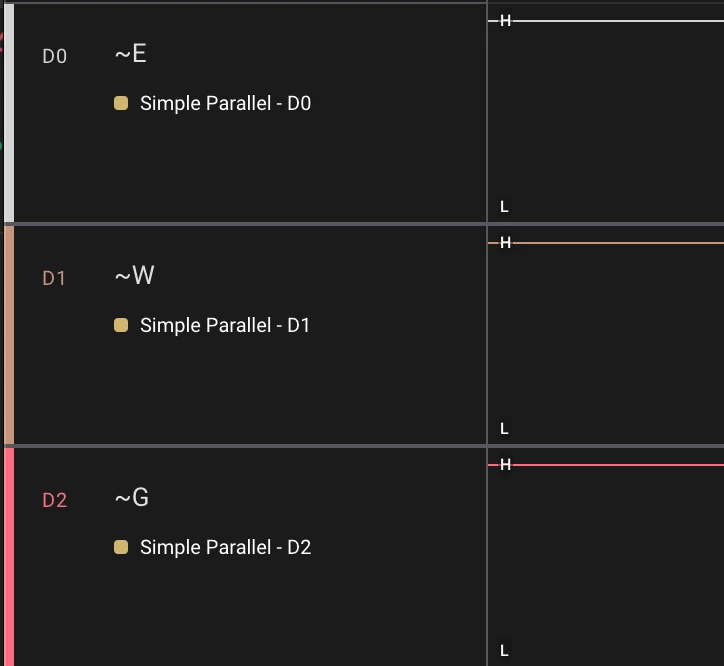

2. in my example, HAL_SRAM_Write_16b does not trigger either ~E, nor ~W. Writing happens (can see it in Memory View in STM32CubeIde) but it is not actually saved in the MRAM. Therefore, data is lost in the next reset of the uC.

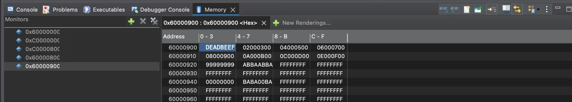

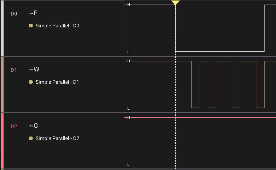

3.  Surprisingly, if I open a Memory View in STM32CubeIde and write in memory "by hand", ~E and ~W get triggered (correct functionality!).

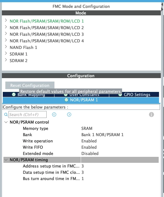

FMC config:

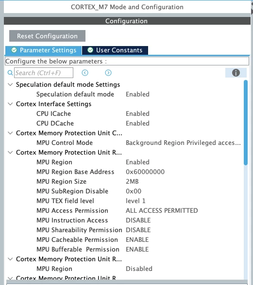

MPU config:

mƎALLEm
mƎALLEmBest answer
Jan 28, 2025 8:13 PM UTC
For this kind of issue/behavior, start by disabling the cache either by using MPU or just do not enable it at your program start.
2 replies
mƎALLEm
mƎALLEmBest answer
SOgal.1
SOgal.1Author
Jan 28, 2025 10:58 PM UTC
Thank you very much @mƎALLEm . Removing those two lines solved the problem:
 /* Enable I-Cache---------------------------------------------------------*/
 //SCB_EnableICache();
 /* Enable D-Cache---------------------------------------------------------*/
 //SCB_EnableDCache();
