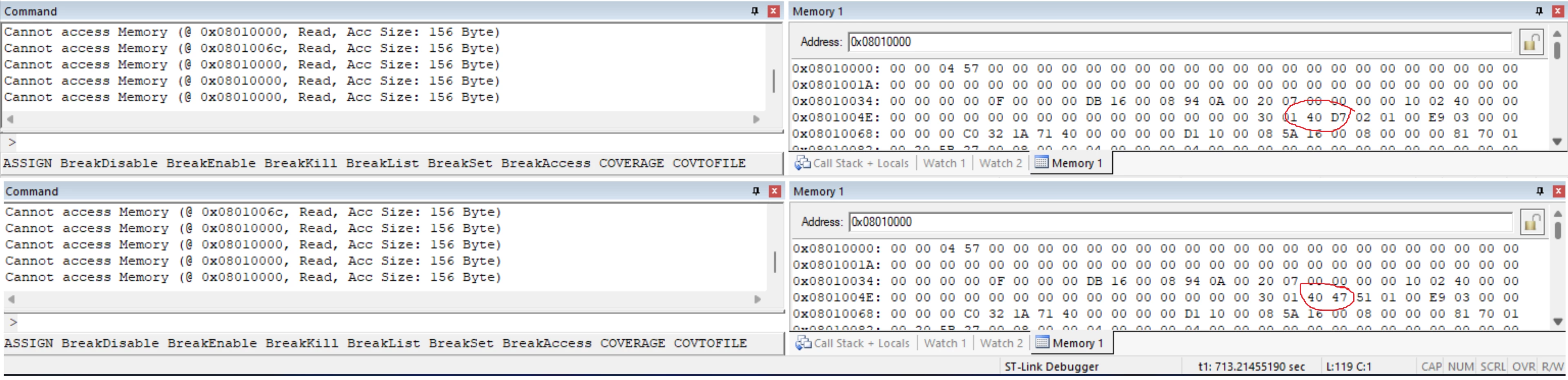

Floating values ​​when writing to memory STM32L422KBT6
Hello, well I have some array of uint16_t data with is contains 50 records. If I truing to write it to the flash memory it looks like it have done an then if I write again, the HEX data in debug mode memory is randombly chenging. Ideally Firstly I need read data from flash(after power off) and write to array, on another iteration if data in array != data in flash, then overwrite flash. To put it sumply this is for manage/store a data in flash. Please help me.

  • How the data change if array is constant after iteration:

Pretty sure the sizeof() here doesn't know the array size
  1. void convert_uint16_to_uint8(uint16_t *src, uint8_t *dst)
  2. {
  3. uint32_t size = sizeof(*src);
  4. for (uint32_t i = 0; i < size; i++)
Couldn't you just cast the array directly?

sizeof() is the size in bytes, if you multiply it and do a byte copy you will overflow the buffer.

No, this reads 200 bytes, and overflows
  1. // Read 100 bytes of data from the flash memory
  2. read_flash(compare_data_uint8_t, sizeof(Holding_Registers_Database_test) * sizeof(uint16_t));
printf("%d\n", sizeof(Holding_Registers_Database_test) * sizeof(uint16_t) );
