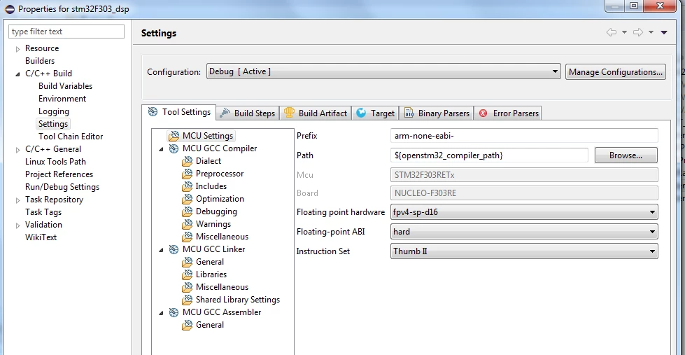

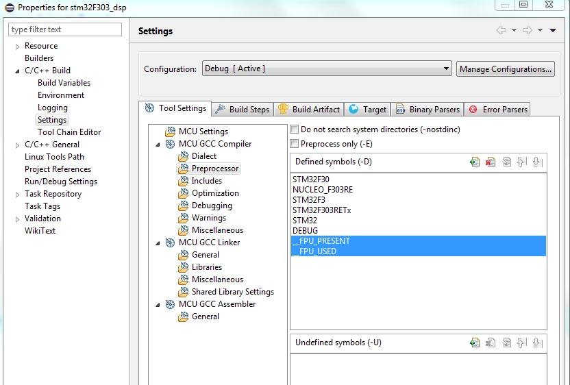

    Can you check the configuration of your project this way:
    Into
    System Workbench Project \ Properties \ C/C++ Build \ Settings \ Tool Settings \ Preprocessor
    Check if __FPU_PRESENT and __FPU_USED symbols are defined
    And then into MCU Settings Floating Point ABI is hard
    Best regards
    Vivek Sankaranarayanan
    Aug 17, 2017 7:42 PM UTC
    Posted on August 17, 2017 at 19:42
    I have both those symbols defined in the preprocessor.

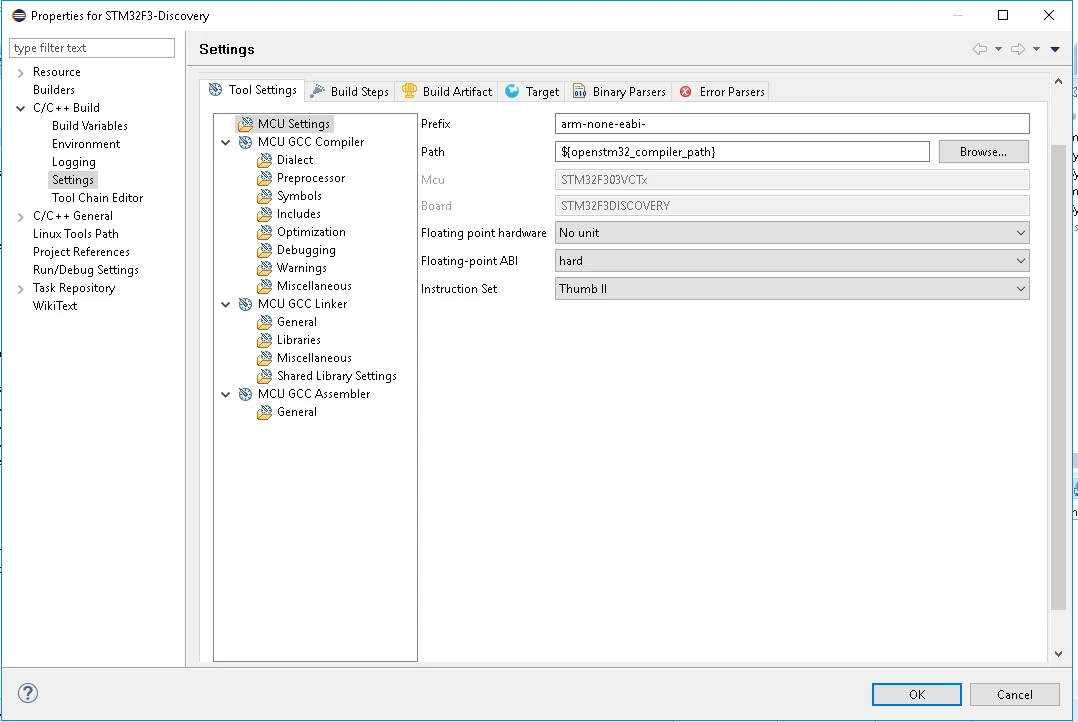

    But my problem could be this. I cannot select anything under Float Point Hardware. I have only No unit listed.
    Could this be the problem?
    RomainR.
    RomainR.Best answer
    Aug 17, 2017 8:36 PM UTC
    Posted on August 17, 2017 at 20:36
    What is your SW4STM32 version ?
    Maybe upgrade to latest version should be fix your issue.
