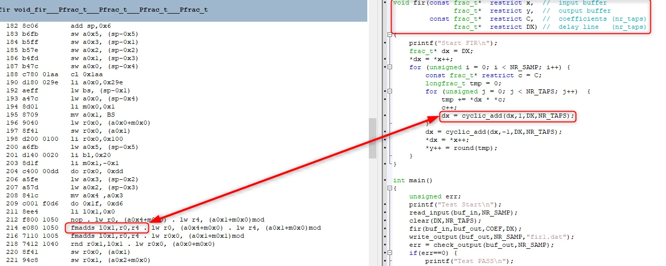

As I checked the example FIR implementation the cycle add function will be realized with fmadds. The assembly command fmadds dealing with two floating point number.
(cyclic_add function is provided by DSP-L /
ST. void* cyclic_add(T* p, int offs, T* start, int len)).The example code is dealing with floating numbers and the floating point calculation will be emulated.
Why convert the compiler the cyclic add function to a floating point assembly command?
(See attached file.)
