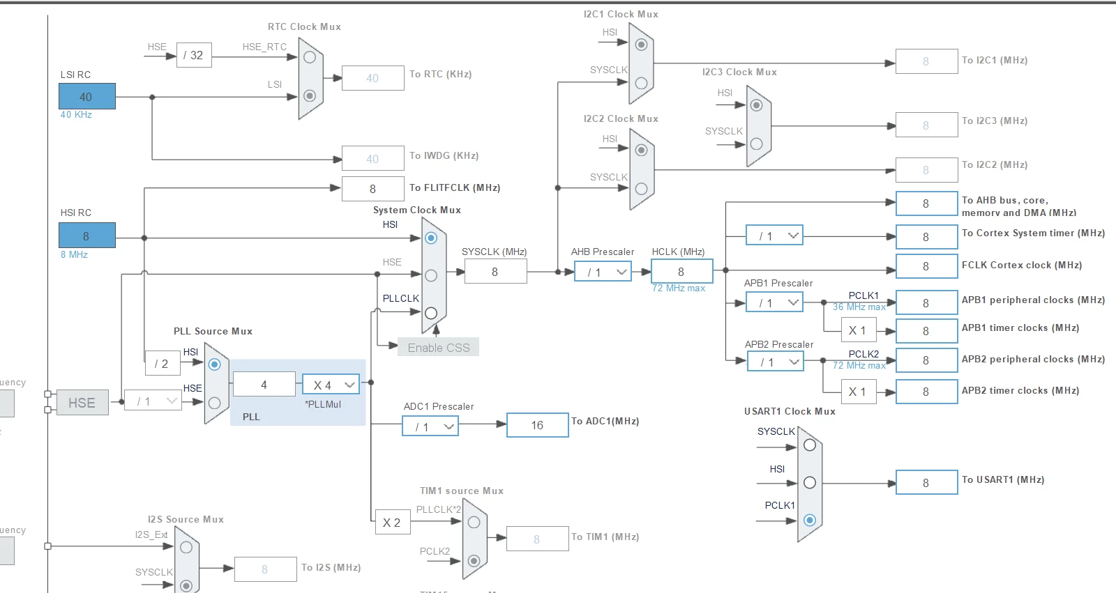

I am not using any external oscillator, but maybe this is the issue ? The ADC1 seems to be connected to HSI and run at 16 MHz based on what CubeMX is showing...
Thank you so much for taking the time to help me and have a good day !

For the clock sources, I attached a screenshot from CubeMX, and I have the following line in my system clock initialization :
PeriphClkInit.Adc1ClockSelection = RCC_ADC1PLLCLK_DIV1;
