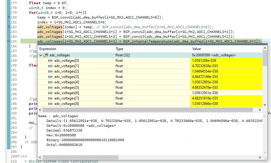

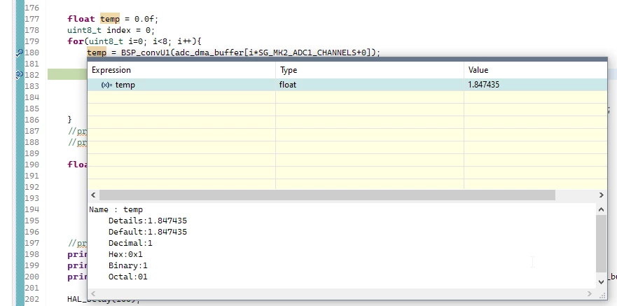

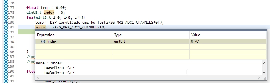

I want to convert a bunch of uint16_t values from an ADC into floating point voltages. For this I use a for loop to loop through the uint16_t array and write the values to a float array. But the float array remains 0 as if no assignment is ever made. Outside of the for loop the conversion works. And when I step through the program with the debugger, I see reasonable float values but they do not end up being written to the array. Why?
the temp float value is 1.847
the temporary index is 0
but the array at index 0 is not 1.847

    If a global variable (adc_voltages[]) has nonzero value before you wrote into it the first time, it means either incorrect software wrote into it (incorrect pointer or out-of-bounds index to array), or incorrectly set DMA wrote into it.
    You should be able to catch the culprit using data breakpoints (a.k.a. watchpoints). If there's no break and the data are changed, then it's DMA.
