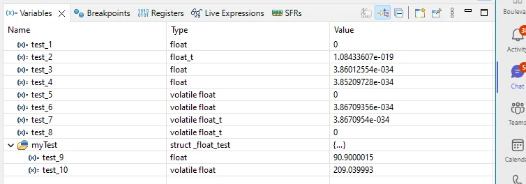

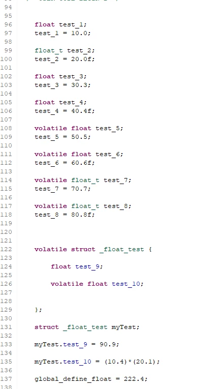

Is there a proper way to implement a float value? When i try to declare a float variable and debug via the variables tab and or live expression (global variable) I keep getting incorrect values in some instances.
I have included the float library and enabled -u_printf_float / -u_scanf_foat.

It could be an issue with the Live expression view
I've seen where the Live Expression did not have correct value, but if you pause the debugger and look at the variable in the Expression tab, the value was correct.

Dec 17, 2024 8:41 PM UTC
You are a life saver!!! That solved my issue.
