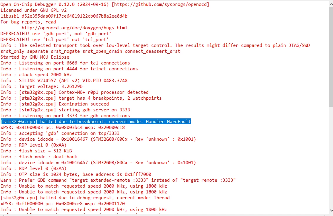

Flashing issue using Zephyr & STLink
We are migrating to zephyr, the board which is supported by zephyr is nucleo_g0b1re, but out actual controller is stm32g0c1ret3. Both are of same family, have same memory and all. I have just made changes in the overlay file for my application, have not touched anything in .dtsi or .dts file. I am facing issue when i try to dump code my my led which i have added in the overlay file. The error says "[stm32g0x.cpu] halted due to breakpoint, current mode: Handler HardFault". Can anyone tell what the possible ways can be due to which this error is occurring while flashing.
I have attached the screenshot of error.

What development host platform?
What tools & versions?
https://community.st.com/t5/community-guidelines/how-to-write-your-question-to-maximize-your-chances-to-find-a/ta-p/575228
Can you program anything else using this environment? eg, an out-of-the-box example?
Can you program using STM32CubeProgrammer?
Have you tried asking at a Zephyr-specific forum?
It would be more helpful to post it as text - see:
https://community.st.com/t5/community-guidelines/how-to-write-your-question-to-maximize-your-chances-to-find-a/tac-p/725146/highlight/true#M54

Hello @vividhadhengre,
According to the provided screenshot, you have a Hardfault probably due to mismatch between your .dts files and the actual layout of the STM32G0. Could you share your modified overlay files?

Hello Sarra,
My nucleo_g0b1re.overlay /{
gpio_interface {
compatible = "gpio-keys";
mechsensor_set_pin_portd5_pin55: PortPinPD5_Pin55 {
gpios = <&gpiod 5 GPIO_ACTIVE_HIGH>;
status = "okay";
