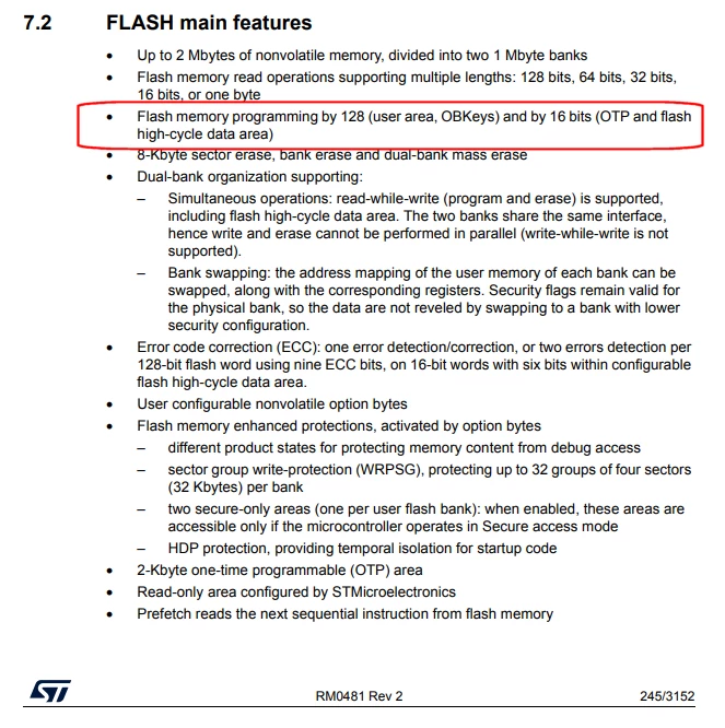

On H5 it looks like it's possible to write flash only with 128 bits sections. On F4 it was possible with 8 bits and 32 bits.

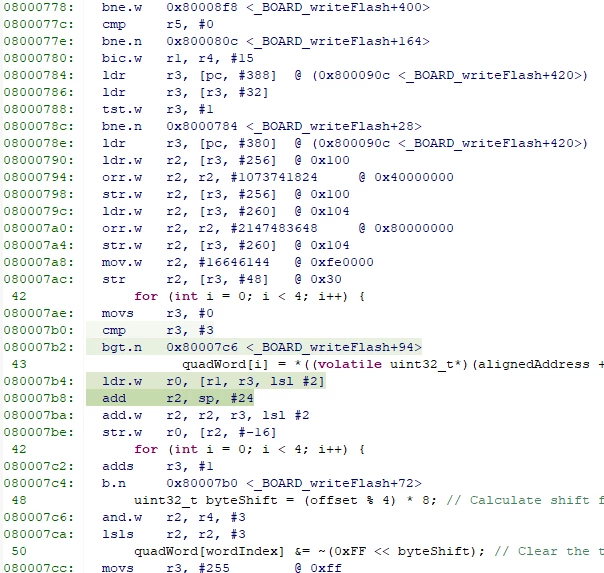

I run onto a NMI right after the first call to "quadWord[i] = *((volatile uint32_t*)(alignedAddress + (i * sizeof(uint32_t))));"
The problematic instruction is "add r2, sp, #24":
Does anyone already faces this issue while porting code from F4 to H5? Any clue or workaround?

FYI I fixed my problem. As I said previously, I work on a software portage from F4 to H5 and I missed a compilation flag change. I left a ```-mcpu=cortex-m4``` instead of ```-mcpu=cortex-m33``` and the consequence was that the instruction set was ARM7 and not ARM8. With the correct flag, the read/write works fine.

On H5 it looks like it's possible to write flash only with 128 bits sections. iate!
Indeed - except the OTP and high-cycle data area:
https://www.st.com/resource/en/reference_manual/rm0481-stm32h52333xx-stm32h56263xx-and-stm32h573xx-armbased-32bit-mcus-stmicroelectronics.pdf#page=245
