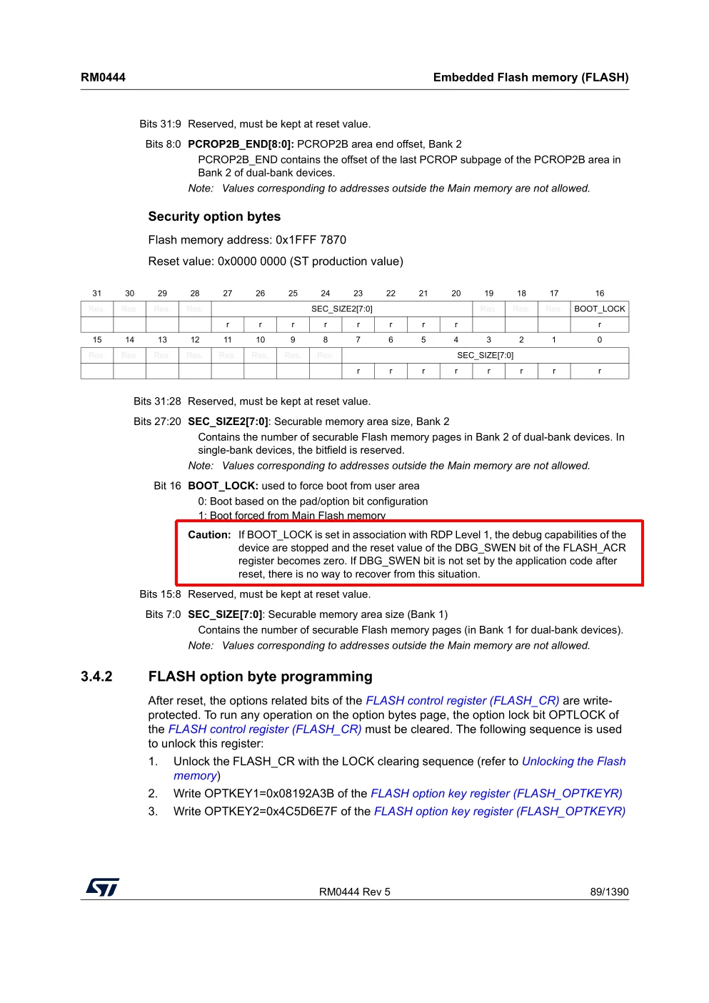

@RE11  At this point, you have lost your board, we suspect that your last code have created OB missmatch that have activated your bootlock.

waclawek.jan
Jun 23, 2023 12:30 PM UTC
Maybe you may try to check state of BOOT_LOCK before trying to set RDP1.
I don't know why would BOOT_LOCK be set, but maybe this is the mechanism through which the chips are "lost".

Sep 11, 2023 11:55 AM UTC
I encounter the similar problem at STM32L422CB. When I set OB_RDP_LEVEL_1 and then call HAL_FLASH_OB_Launch the MCU does not boot anymore. When setting OB_RDP_LEVEL_0 there is no problem. I have not tried OB_RDP_LEVEL_2.
Surprisingly, when I set the OB_RDP_LEVEL_1 without calling HAL_FLASH_OB_Launch but doing a manual power off-on, there is no problem at all and everything works as it should.
I guess the problem is the HAL_FLASH_OB_Launch procedure.
