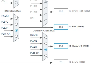

The stm32h747 controls Flash memory using qspi.
Flash is using mt25ql256.
Write and Read actions have been confirmed.
But the frequency doesn't come out like a data sheet in flash memory.
The speed of the QSPI clock is around 1.25Mhz.
QSPI  ClockPrescaler  : 2
The frequency does not come out like a flash memory data sheet.
I want to know what the problem is, please help me!!

Unpack the clocks as the MCU sees them.
 printf("\n\nCore=%d, %d MHz\n", SystemCoreClock, SystemCoreClock / 1000000);
 printf("HCLK=%d\n", HAL_RCC_GetHCLKFreq());
 printf("APB1=%d\n", HAL_RCC_GetPCLK1Freq());
 printf("APB2=%d\n", HAL_RCC_GetPCLK2Freq());
Likely not running with the bus clocks you think it is.
Check the clock initialization code doesn't fail, either HSE or PLL failing to come ready would be my guess.
