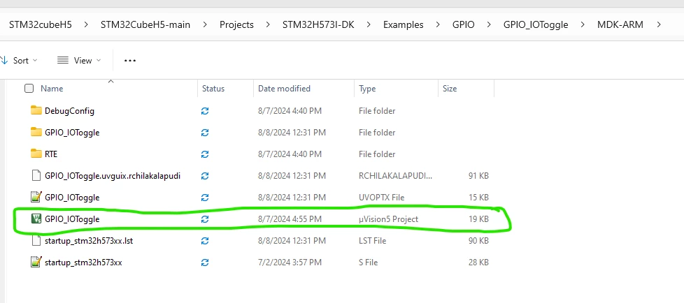

I have rebuild the above code in Keil and tried to load then i got below error. Could you please help me to start with the board.
Thank you.

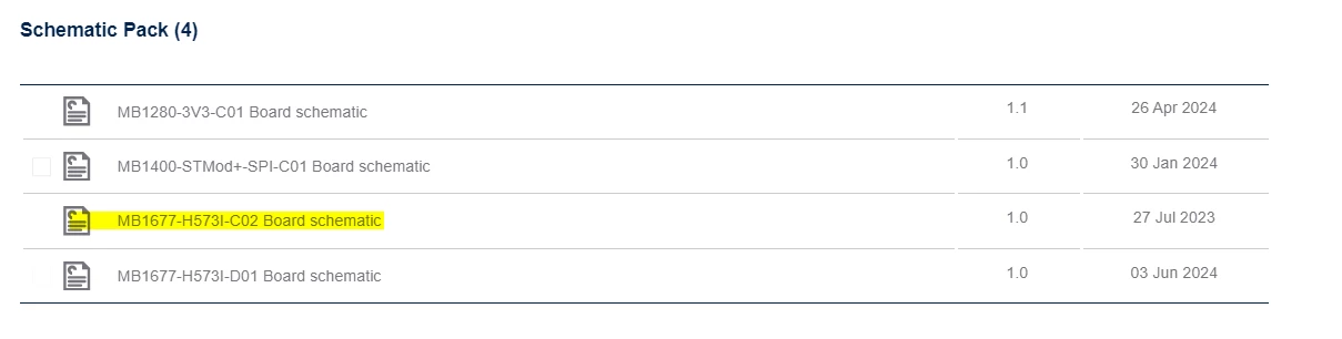

All STM32H573I-DK documentations are available here.
Also you can find the schematic for STM32H573I-C02 board in CAD Resources.

Hello @rchilakalapudi and welcome to the Community :),
Could you please precise which versions of:
- Keil toolchain
- STM32CubeH5 firmware
-STM32H573-DK board
I tested GPIO_IOToggle example under STM32Cube_FW_H5_V1.3.0 using Keil 5.39 and STM32H573-DK-C01 and I can load without issue.
Are you able to load any other examples?

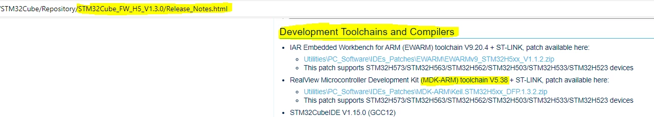

Hi @rchilakalapudi ,
Could you please update you Keil toolchain version.
The development toolchain for STM32Cube_FW_H5_V1.3.0 cube firmware is MDK-ARM 5.38 as mentioned in release notes.
Thank you.
