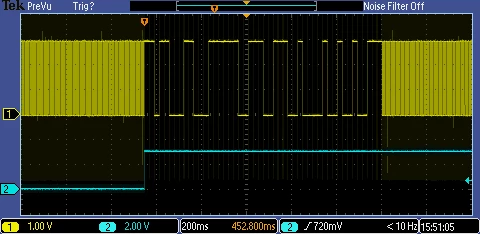

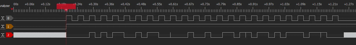

I am testing doing flash erase while running code from internal SRAM on a STM32F072B Discovery Board. Having initializing everything with code running in flash, I call a function where itself and all its dependencies exist in RAM. I've verified this in many ways: code analysis, stepping through debugger, etc. I have also copied the ISR vectors to RAM at 0x2000_0000 and used SYSCFG_CFGR1 register to remap SRAM to 0x0000_0000.
I have TIM2_CH1 setup as a 100kHz timer and increment a tick variable each interrupt. The interrupt also toggles a GPIO pin every pulse. Currently that is connected to an LED so I can visualize what's going on, but I have tested with a bare pin at GPIO_SPEED_FREQ_HIGH as well with the same results.

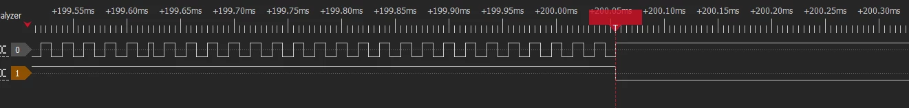

All of this works fine as long as I don't do the flash erase cycle. But as soon as I erase a few pages of flash, the LED starts flickering quite a bit like the GPIO bus is being blocked. The datasheet says that flash should only block the flash bus; running in SRAM is supposed to avoid CPU stalls. The GPIO also doesn't seem to be on the same bus. So my question is why is this happening? I have attached some logic analyzer captures of the GPIO. In the macro view you can see two white blocks on the left and right ends. This is the 100kHz signal. Once the signal becomes sparse that is when flash erase is in progress. The toggling is extremely slow and erratic during this time frame. I also attached a close up on the 200kHz signal to show that it is functioning fine outside of the flash erase cycle.

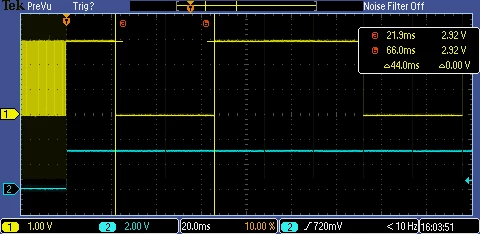

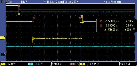

But I ran it today on the oscilloscope. Looks more or less the same. Don't see any obvious signal integrity issues. There is some bad ringing but I think that's just my probing technique. I've attacked some screencaps showing the full flash cycle and zooms with smaller horz scale with cursors including a closeup of the "glitch." I'm not really sure what's causing that.

Where/how are LEDs defined?
Is SB16 closed?
Try toggle a different pin, perhaps not in VDDIO2 domain. Try to toggle it in the loop waiting for FLASH programming finished.

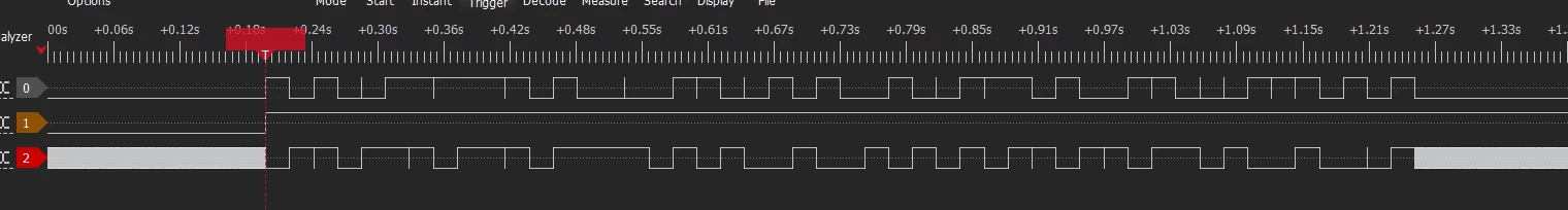

I checked that SB16 is closed; it has a zero ohm resistor across it (checked with DMM). II have also added a new toggle on PB15 (not on VDDIO2 domain) that toggles after each instruction in the My_PageErase function as shown below:
static void NOINLINE FLASHAPI My_PageErase(uint32_t PageAddress)
/* Proceed to erase the page */
My_GPIO_TogglePin(GPIOB, GPIO_PIN_15);
SET_BIT(FLASH->CR, FLASH_CR_PER);
WRITE_REG(FLASH->AR, PageAddress);
SET_BIT(FLASH->CR, FLASH_CR_STRT);

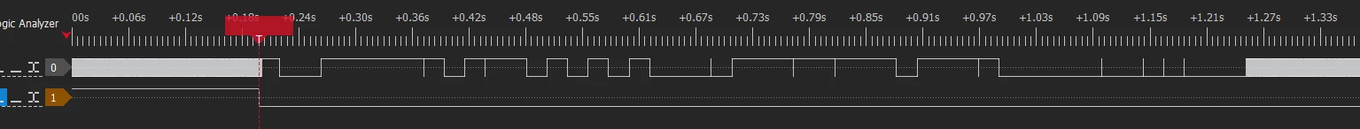

I've switched back to using the LA because it's simpler to capture. Let me know if you want oscope. Channel 0 is now the PB15 signal and Channel 2 is the LED. This is what the above code produces:
I tried adding the toggle also to the WaitForFlashComplete function inside of the loop and that produces this:

Most intriguing, yet I have no explanation. As if the AHB2 bus (dedicated to GPIO in 'F0) would be stalled during FLASH programming, yet would not throw wait to the processor.
I believe, only ST can explain this, so you may want to contact them, probably through the web support form.
