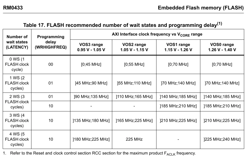

I am running the flash peripheral / AXI bus at 240Mhz and I have the flash wait states set to 4 WS (5 Flash clock cycles). I have followed all the guidelines related to the HW design and have the correct core capacitance on the VCAP pins. I write 256 bits of data to the flash memory approximately every 10 seconds to save the state of my device (of course I increment the write address after each write so that I'm not writing to the same position every time). When the sector is filled, it is then erased and then I start writing to the start of the sector. I also set the BOR bits to the highest voltage setting to try and prevent brown-out issues. I think these are most of the important settings you need to know.
Today while looking at my register settings in debug mode I noticed that the WRHIGHFREQ setting was set to 3 (aka 11) by default... I can't find anywhere in the HAL / code where this is done so it must be set automatically. The manual only lists valid settings for 0, 1, and 2 (see below). Can anyone tell me what the behavior is of the STM32H743ZIT6's flash module is when a setting of 3 is used for WRHIGHFREQ? Is it just invalid / undefined? Maybe this is my issue?

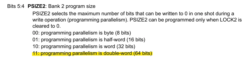

I think it is "good". I am using a voltage range of 4 AKA a programming parallelism of double-word. I assume this is OK. There is no documentation in the reference manual about which is "correct" - it is just a tradeoff between timing and power consumption.0693W00000StuF9QAJ.png

Please check the Flash register FLASH_ACR in Reference Manual Reset value: 0x0000 0037. So 3 stands for WRHIGHFREQ (Bits 5:4) and 7 stands for Latency
Also note that the application software has to program them to the correct value depending on the embedded Flash memory interface frequency.

Thank you for the response. I forgot that all registers have a default reset value that is defined in the reference manual. Thank you for pointing that out. Still, the reset value, 3, is not a valid setting for WRHIGHFREQ for any clock frequency on STM32H743 according to Table 17 in RM0433, which I think is strange.
In addition, neither the HAL or STM32CUBEMX platform handle setting this value, even though they handle the LATENCY - the auto generated code for 240Mhz AXI Bus sets the LATENCY to the recommended value but does not set the WRHIGHFREQ.
Unless the user reads the reference manual and happens to see Table 17 and then goes digging in the FLASH LL drivers, they would probably not know how to set this setting.

3- My understanding is that a value set to 3 for WRHIGHFREQ shouldn't create an issue. The reset value covers all intended frequencies in the table but in larger latency. Can you change WRHIGHFREQ to the value 0x2 for example? If you confirm that updating this bitfield resolves the issue, we need to investigate this on our side and report it internally for HAL and CubeMX implementation.

  3. I have changed my WRHIGHFREQ setting to 0x2 and issued a firmware update to all our users. No issues yet but it has only been 5 days. This issue is unpredictable. It has happened to me personally 2 or 3 times over the last 4 months and only 4 times to the 40 units we have in the field.

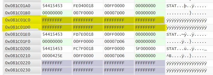

Hi @F.Belaid​ I have made an interesting discovery regarding this issue. I discovered it while analyzing the timing of the flash erase and write requests.
I am noticing that sometimes (it seems) a "state" write fails and we are left with an unwritten block in memory. I don't know why it fails yet but I noticed that there is an unwritten 256 bit block in memory. The system assumes that this previous write was successful and starts writing the next block 10 seconds later.
During the next bootup, the program scans for the last 256 bit block in memory with the first word being "STAT" in ASCII. It sees this blank block where a write failed and assumes that the block before it is the last successful saved state. It then starts writing its state from here. It will eventually overwrite the following two 256 bit blocks, which cause an ECC code to trip. It sometimes happens immediately when the following blocks are overwritten or during the next power cycle.
Now I just have to figure out what is causing the block writing failure.

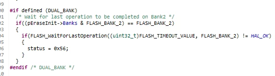

It seems during the second scenario, an HAL_ERROR is returned by HAL_FLASHEx_Erase().
jaakjensen
Sep 14, 2022 9:16 PM UTC
The error reported in HAL_FLASHEx_Erase() is from this section. I modified the return status to confirm which section reported the error.: 0693W00000SvOVAQA3.png
jaakjensen
Sep 14, 2022 9:39 PM UTC
It seems like this error may be from a "RDPERR2" ? The PFLASH error code returned is 0x8080_0000. Which is strange because I have not set up a PCROP-protected word or a RDP-protected area.
