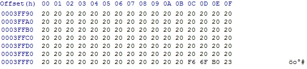

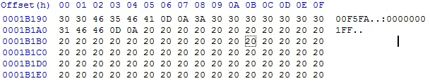

    And ending of the modified .hex file (the first space (20) is right after the program the compiler generates): 0690X0000060547QAA.png etc... and ending: 0690X000006054HQAQ.png How does the compiler/linker know where the .hex program ends. Because it seems to me it does not upload the entire .hex file? You were talking about some tags? Could you please explain this? Really stuck, and appreciate any help and advice (again...). Thank you and best regards, K

    ''Anyway, regarding the CRC calculation (following clive1 advice), I have created a simple program that reads the .hex file, pads the file with space characters up to flash size minus 4 bytes (0x00040000 - 4) and calculates the CRC. This CRC is then appended to the .hex file which yields the total size of the .hex file 0x00040000. The CRC of the entire file is then calculated and the output is indeed 0 (please see the image below)?''
    Did you read this file as an Intel Hex?
    Did you interpret the binary image correctly?
    ''First, I have successfully uploaded the .hex file (without CRC check) to the controller and the code works fine. But uploading the program with the CRC check, the program loops in a while loop I have placed within the code after the CRC calculation:''
    Did you write a new Intel Hex file with your CRC changes and load that?

    The .HEX is a packaging format, this is technically not what gets uploaded to the part. So you need to be sure you're doing the CRC of the binary data encapsulated by the file, not the hex data file itself.
    The linker knows the size of the things it's creating, these are also expressed in the .ELF/.AXD file in descriptors about the various sections. From the .HEX file the end can be inferred from the last described location (maximal address). One would typically have the parsing app know the size of the finished ROM, it would fill the space with something like 0xFF, and then fill in the content by processing the .HEX file.
    By tagging it, I mean you can put size and other data into the image in a post link step. For instance you could have a ''static const unsigned char sig[] ='' type construct and the tool you add thing like a size, or serial number to that before performing the check summing, etc. You could also place the size, or other information into unused vector table entries.

    void FlashCrcTest(void)
     uint32_t CrcExpect, CrcCompute;
     uint8_t *RomBuffer = (uint8_t *)0x08000000;
    #define ROMSIZE 0x40000
     CrcCompute = ~Crc32FastBlock(0xFFFFFFFF, (ROMSIZE - 4), RomBuffer);
     CrcExpect = *((uint32_t *)&RomBuffer[ROMSIZE - 4]);
     if (CrcCompute == CrcExpect)
     puts("Success");
     else
     printf("Fail %08X != %08X\n", CrcCompute, CrcExpect);
    Edit: Stupid forum ballsing up posts

    I am using Keil, which outputs a .hex but can be configured post build to output .bin also (using fromelf).
    Step 2:
    For validation I would preferably like to use the STM32's inbuilt CRC calculation. I have configured the CRC peripheral and also wrote a custom function which calculates the CRC in the same way. I've tested the outputs of both on the same data (entire ROM) and the output was the same.
    Step 3, 4, 5 -> here is where my problem lies. It seems I do not know how to properly calculate the CRC for the .bin image and inject it to the end of the image.

    So if I calculate the CRC of the entire ROM minus 4 bytes and append the calculated 4 byte CRC at the end, and then use the same CRC algorithm on the entire ROM, the result will not be zero? Guess that was my first fundamental mistake...
    The algorithm you provided should give the same output as the one I attached in the last post (minus the last 4 bytes), right?
    Again, my main problem is I do not know how to properly fill the entire ROM, i.e. the .hex/.bin file (minus the last 4 bytes), calculate the CRC and append it to the end. It seems strange to me that there is so little information regarding this on the internet. The document of the STM32 states that the CRC is used for flash integrity check, but there are no examples or guidelines how to do this. As I have read, IAR has this integrated in the SW.
    I would just need some standard procedure on how to verify the flash integrity using the CRC peripheral.
