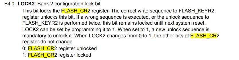

I am attempting to temporarily disable Flash ECC interrupts, for the purpose of validating data stored on internal flash, and discovered that the ECC Interrupt Enable settings seem to have no effect.
I am using an STM32H743, and have used the code below to intentionally trigger ECC interrupts. I experience the same interrupt (HardFault_IRQ), with the same FLASHn_SR values when a byte with an ECC mismatch is read, whether or not FLASH_CR_SNECCERRIE and/or FLASH_CR_DBECCERRIE are set. I have verified the bit settings via ST-Link/V2 ISOL debugger both before and after the interrupt occurs, and I'm using STM32CubeIDE.

Hello @NickFF,
For the FLASH_CR_SNECCERRIE and FLASH_CR_DBECCERRIE interrupts to be effective, the LOCK2 bit should be cleared to 0.
Check:
