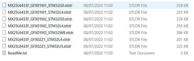

I'm using Nucleo-G474RE  + X-Nucleo-GFX01M2
I downloaded the X-Cube-DISPLAY package
I cannot find a flash loader file for the Nucleo-G474RE in the ExternalLoader folder. See below screenshot
Where to find an ExternalLoader file or can I use one of the below ones?

None of these are likely to work as they are board and architecture specific
I'll look to port the Macronix loaders to the G4 in the next several days as time/resources permit
https://github.com/cturvey/stm32extldr/tree/main/gfx01m2_mx25l6433f

Hi Tesla
Thanks for you quick respond and offered help.
Just to be sure: please generate flash loader to be used with Nucleo-G474RE board
(or is this same for all STM32G4xx micro's?)
Waiting for your file
