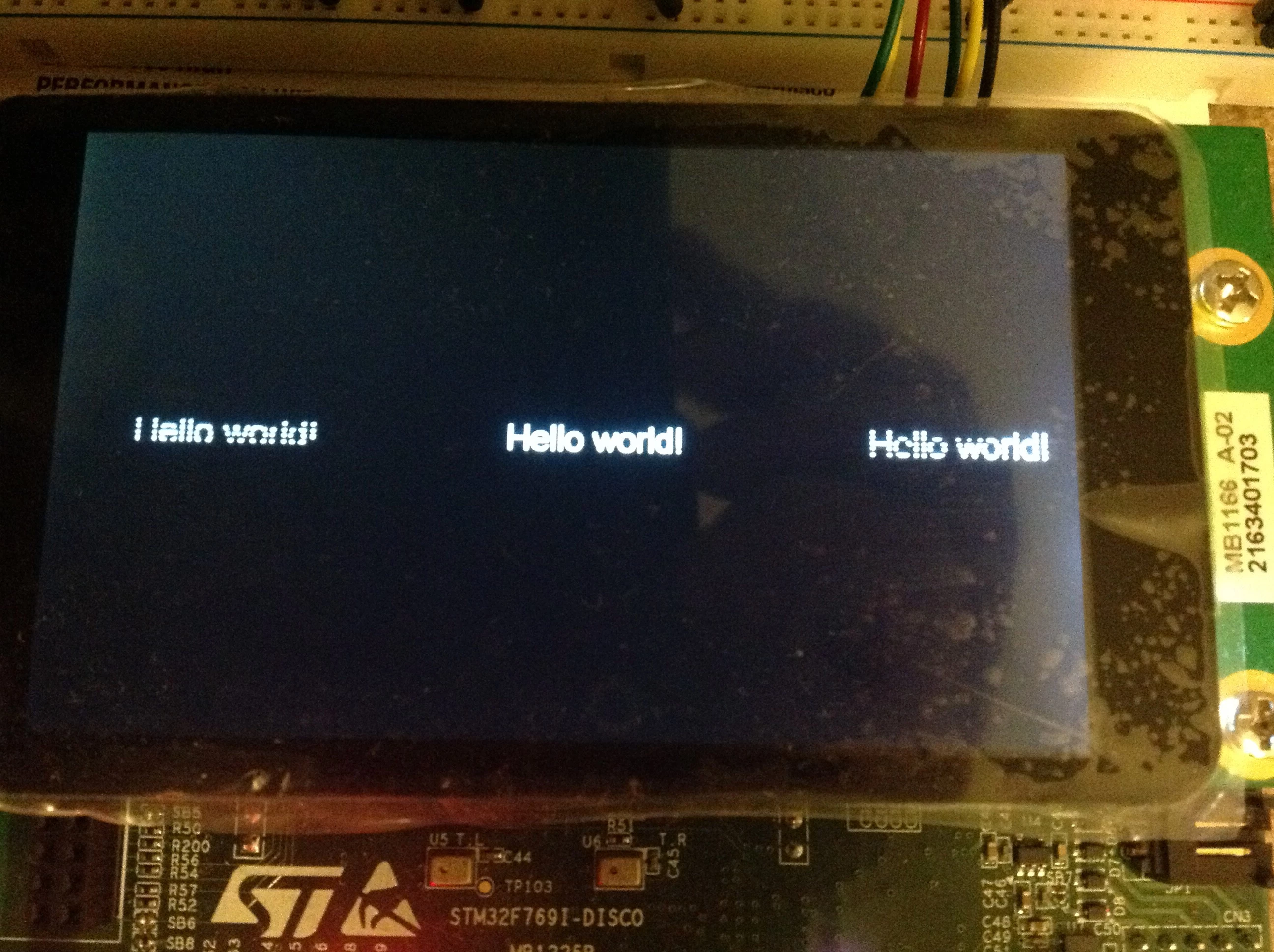

Looking to straighten out my LCDConf but I don't know where to begin.
What is it called when a screen does this? Please see the attached image. If i knew what it was called when a screen does this, I could at least start somewhere with LCDConf.c
I'm trying to run the 769I_Eval STemWin Hello_World on a 769I-Discovery.

    Hi
    doe.john.016
    You can refer to one of the many LCDexamples within STM32CubeF7 to see their LCDConf.h structure and get inspired from them to configure your files: LCDConf.c/.h
    More details about LCD configuration provided in the AN4323, section “3 How to use STemWin Library step by step�?.
    Hope this helps you.

    these aberrations of ghosting text are usually due to the wrong pixel frequency or the wrong Screen width/height.
