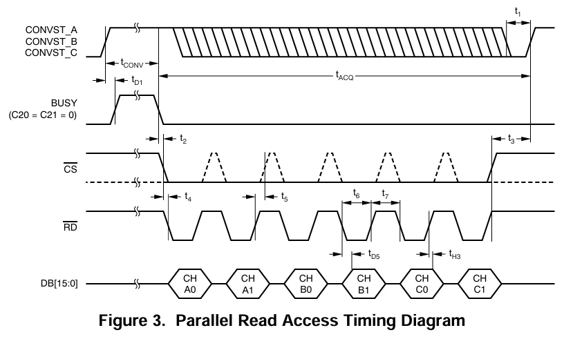

I'm using an STM32H753ZI, specifically the Nucleo H753ZI board, to read data from an ADS8556 adc. Upon signaling to the ADS8556 to start a conversion, a BUSY signal on the adc goes high and falls when the data is ready to be read.
I currently have BUSY connected to PG13, set up as HRTIM1 AF2, with falling edge sensitivity and configured as External Event 10. I have nRD set up on PG6, HRTIM1 CHE1, with its SetSource configured to HRTIM_OUTPUTSET_EEV_10, and its ResetSource as HRTIM_OUTPUTRESET_TIMCMP1, in line with the desired pulse width. For CHE, I also have `ResetTrigger = HRTIM_TIMRESETTRIGGER_UPDATE | HRTIM_TIMRESETTRIGGER_EEV_10`, continuous mode (I've also tried SINGLESHOT_RETRIGGERABLE), and repetition counter = 4.

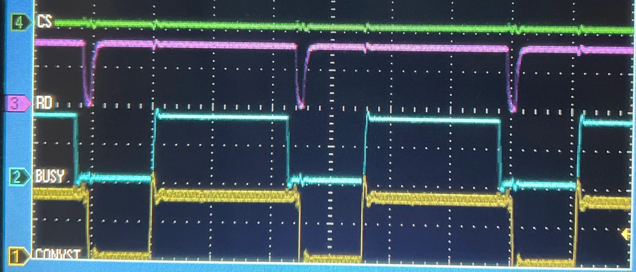

With this setup, I'm seeing nRD (PG6) pulse once on the falling edge of BUSY, and not the desired 5 (I'm only reading from 5 channels out of 6 on the ADS8556). I've played around with a number of HRTIM configurations, but this is the best I've managed so far. It appears RepetitionCounter is not doing anything, maybe I'm misunderstanding completely.
Am I even on the right track? To distill down my goal, I want to be able to generate 5 active-low pulses on a pin, triggered by the falling edge of an external signal. Another future consideration is I will also need the pin for these 5 pulses to trigger DMA transfers.
