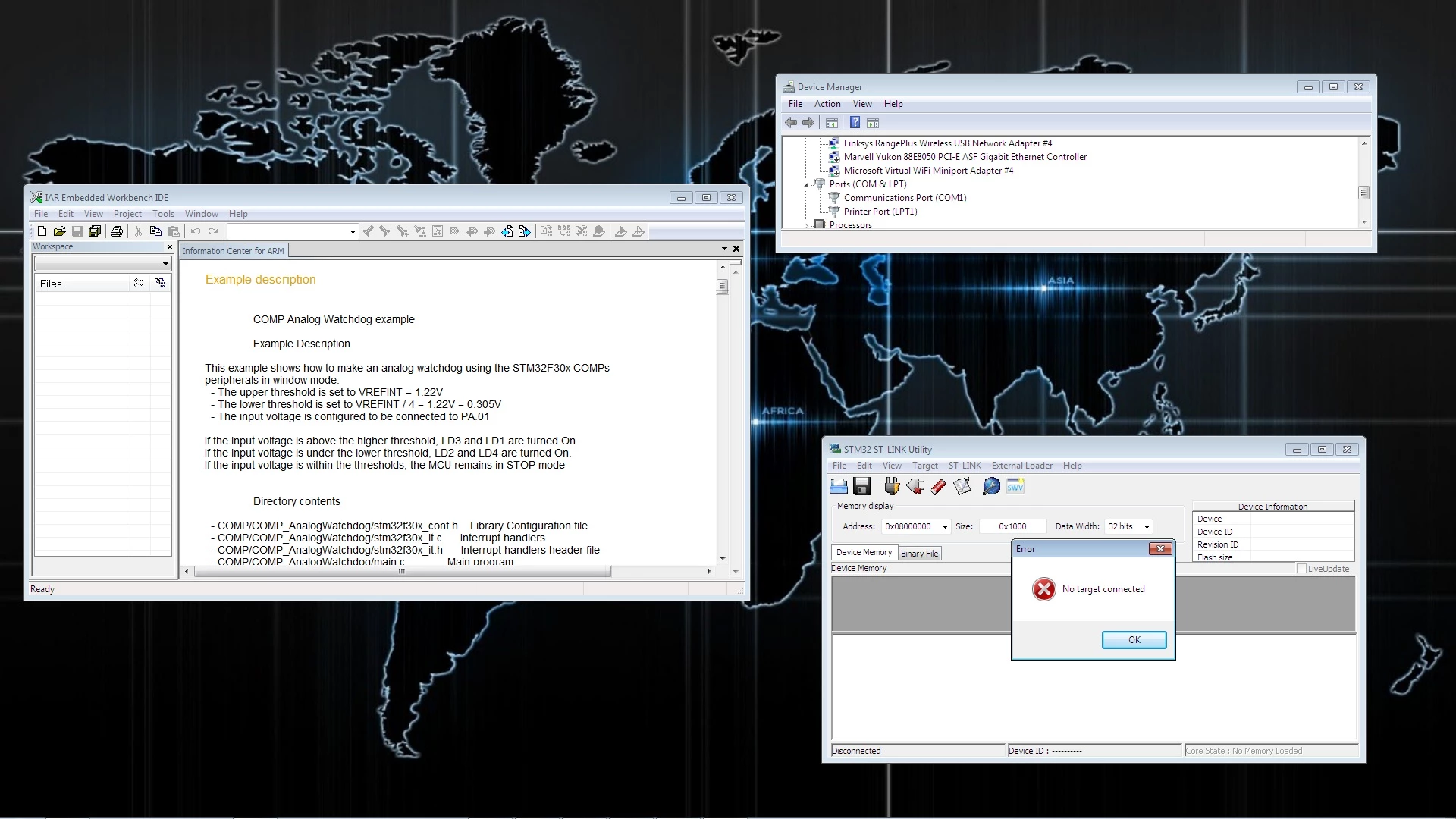

I am using a STM32F303 Discovery board and am not really sure where to start. I am attempting to use EWARM and ST-Link Utility together. Never having downloaded code to anything more complex than Arduino, etc., I am a little lost.
To simplify this post allow me to just list a few q's and comments:
ST-Link Utility: ''No Target Connected'' (nothing ST related in device mgr)
Can EWARM ''Program'' code to my board? (assuming ''no'' but still not sure)
LD2 blinks ON/OFF during pre-loaded demo prgm (never did this before)
EWARM is my toolchain, what does that mean? (i.e. what is a toolchain exactly?)
I feel like I should use EWARM to create projects and ST-Link Utility to ''Program'' the board. Do I understand the general procedure correctly?
Sorry to be the newb
Thanks in advance
See Attachment
    Means there is no connection with the target processor - will not be able to program or debug unless this is rectified. Note : ST-Link Util is only used to program - it cannot debug.

    Thank you for quick and detailed response. I can maybe get something coded if I can get the board to be recognized by the computer. Any idea why it is not seen by Windows?
    The board was initially plugged into computer and ran demo program fine but was not seen by Windows 7; now it flashes LD2 and is still not seen (demo prog seems to run fine otherwise). I will try other ports but am not sure what to do beyond that. Are there drivers somewhere?
    There are 2 USB ports on the STM32F3 discovery board (if I remember correctly). One is for STLink and the other is for USB peripheral implementation. Make sure you have the correct port plugged in to us STLink.

    Thank you for the replies, but I am still really stuck. I do not see any driver files related to ST in my \System32 directory and am even more concerned that the STM32F303 Discovery board is not seen by Windows (in Device Manager). Since it is not there I cannot even try to update the driver through the Control Panel.
    I am using the USB ST-LINK port on the demo board.
    Also still wondering about the blinking LD2. Is this demo code accessible somehow or available on the internet where this might be diagnosable?

    I have plugged in the board to each of my USB ports while monitoring the Device Manager and cannot see it appear anywhere.

    You see nothing? Not even unrecognized device?
    Does Device Manager recognise that something has changed when you plug in the Discovery board via STLink/USB?

    I don't see anything show up (I looked especially close in the USB Controllers section). I have tried the board on my desktop, my Macbook (and its virtual machine - Win7), and my friend's laptop running Windows 7. I never like to blame new hardware, especially because that's usually not the problem. So I still feel like it's something I'm doing wrong. I tried the USB USER port just to check if it would show up but it did not.
    Also, I went through the code to try to find the error associated with the blinking LD2 to no avail. All the other LEDs are named LED3, LED4, etc. but there is no LED2, or LD2. I'm not sure if the blinking LD2 is associated with the board not being recognized.
    There were many times when I first got the board that the program ran normally without the blinking LD2, but I was looking for it under Ports and not under USB Controllers so I cannot be sure that it was or was not recognized during those times.
