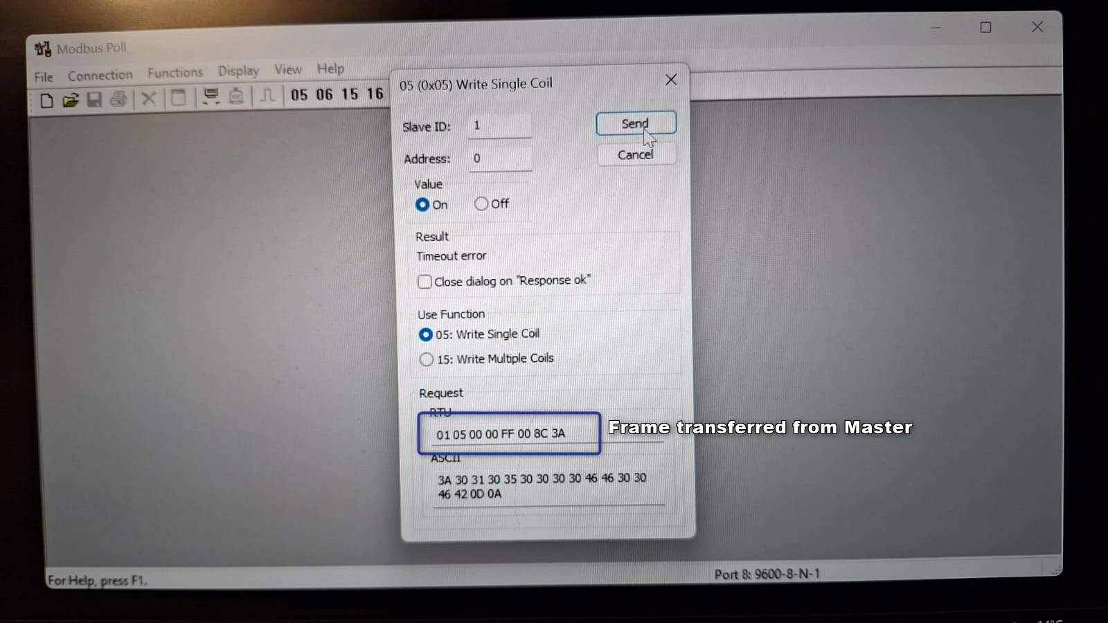

I am trying to implment MODBUS Slave RTU with STM32F030C8T6. I havce used RS485 for physical layer for communication.
As per MODBUS protocol, a stream of 8 bit data will be sent from Master.  As a first step slave must capture all the data in an array, then process the data, do the required action and send back data.
In MODBUS if there is silence of more than 3.65 milli seconds (for Baudrate of 9600) slave can decice that Masfet has finished the data transfer.
I have used UART1 in Interrupt mode (RXNE) to receive the UART data and fill it in the array. Whenever a character is recived by UART, I reset the timer 3 to restart the timing of 3.65mS. If no data comes from UART for more than 3.65ms, slave will decide as teh frame is completed and start next actions.
As of now, to analyze the received data, I used conditional statements and digital outputs inside while loop. I have oscilloscope too.
Now the issue is.

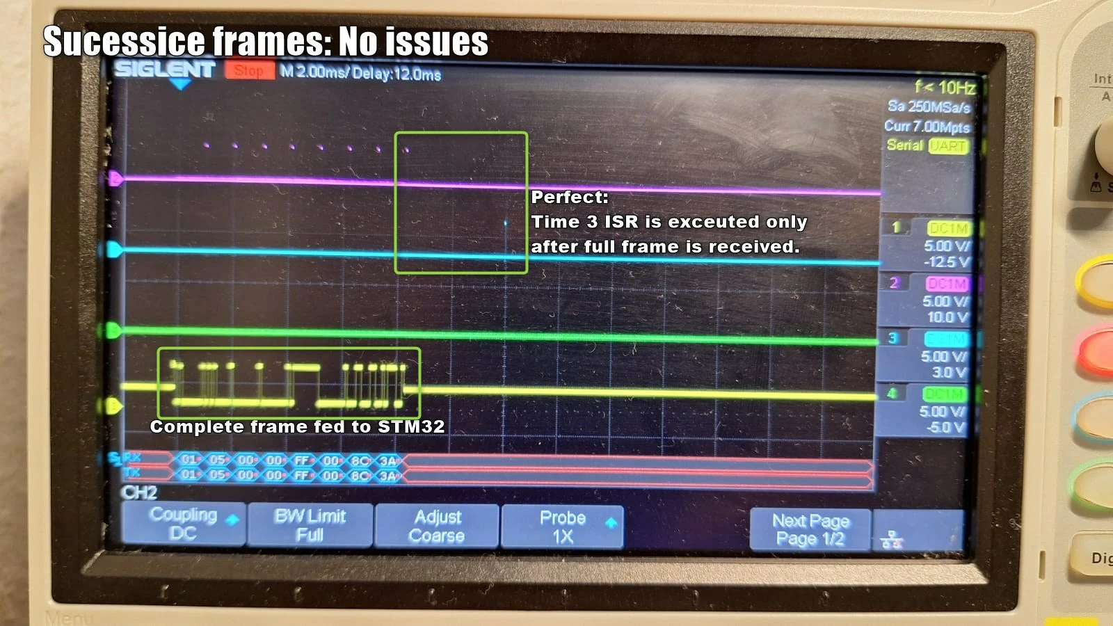

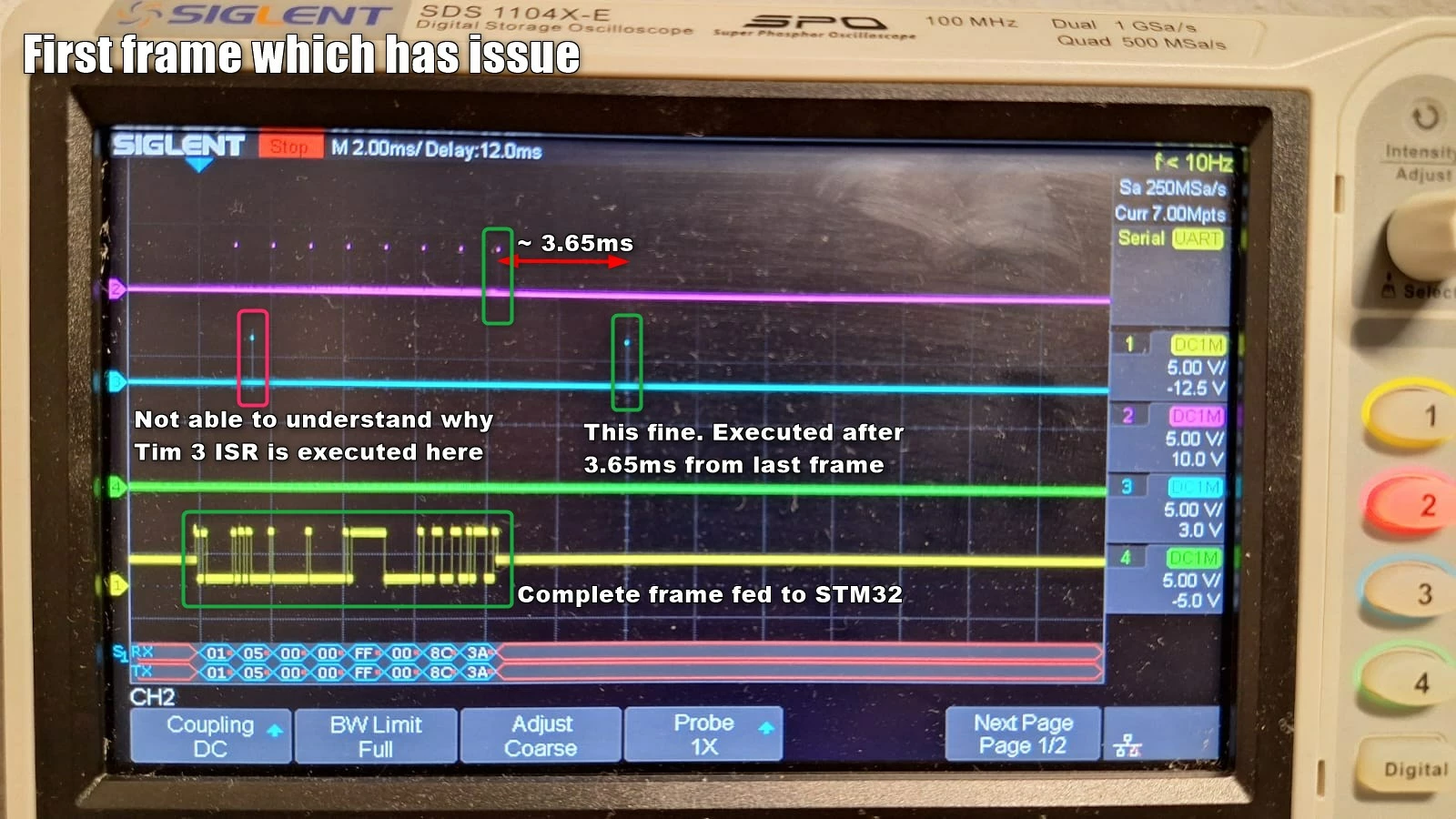

When ever board is restarted and, first frame is sent, timer3 ISR is executed during the frame is being transmitted. WHich means timer is not reset inside the UART ISR. but this issue is present only during the first frame transfer. FFor all the later frames, timer3 ISR is exceuted perfectly after the set time is elapsed. Also the data filled in the array is also corrcet.. For your reference I have provided my full code below

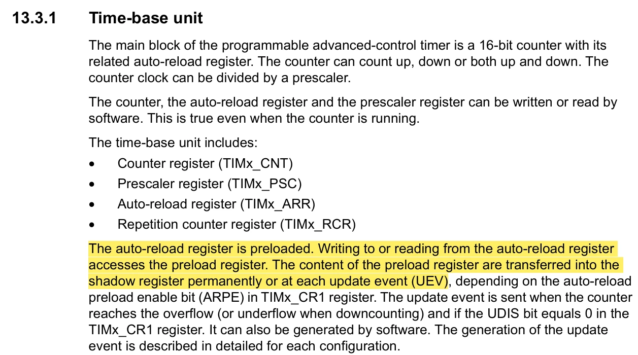

TDKBest answer
Apr 19, 2025 11:20 PM UTC
ARR and PSC are preloaded. Generate an update event (and ignore/clear resulting update flag) to have them take effect immediately.

Anesh
AneshAuthor
Apr 20, 2025 8:38 AM UTC
Thank you for your hint. Now I modified my code as below. It is working great. Still if you feel that I overdo something, please let me know. Thank you so much for your hint.

Apr 20, 2025 12:35 PM UTC
Looks good.
To clear UIF, you should write 0 only to that byte. Doing a read-modify-write (&=) can clear other flags. Not an issue here but could be if you were using them.
TIM3->SR = ~TIM_SR_UIF; // Clear UIF
