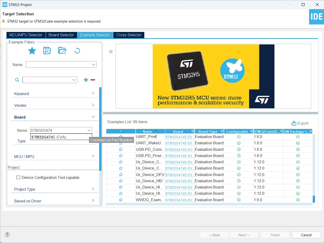

I have the STM32G474 Discovery Kit and am just attempting to get a blinky LED program to work on it for right now.
In the STM32CubeIDE, I imported an example, was able to get it to build correctly (after changing references from caddr_t to void*)  and it seamed to download to the device correctly (verified and everything) after hitting the debugger button. When I pressed run, however, nothing changes on the board.
I ended up using the STM32G474E-EVAL example since I was not able to find a blinky LED program for the Discovery Kit. Or any example for the Discovery Kit.
Maybe I am not looking in the right place or perhaps searching for it incorrectly?
Are there examples for the G4 discovery kit? And if not, how easy is it to port the examples that I do have to my specific board?

Not all boards are available in the Example Selector, but you can find examples for your board here:
https://github.com/STMicroelectronics/STM32CubeG4/tree/master/Projects/B-G474E-DPOW1
They will also be available locally on your computer under C:\Users\%USERNAME%\STM32Cube\Repository

Aug 14, 2023 3:15 PM UTC
I was able to download and run the examples with no problems.
Thanks!
