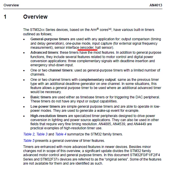

AN4013 seems to suggest that any 'General-Purpose' or 'Advanced' Timer can do it:

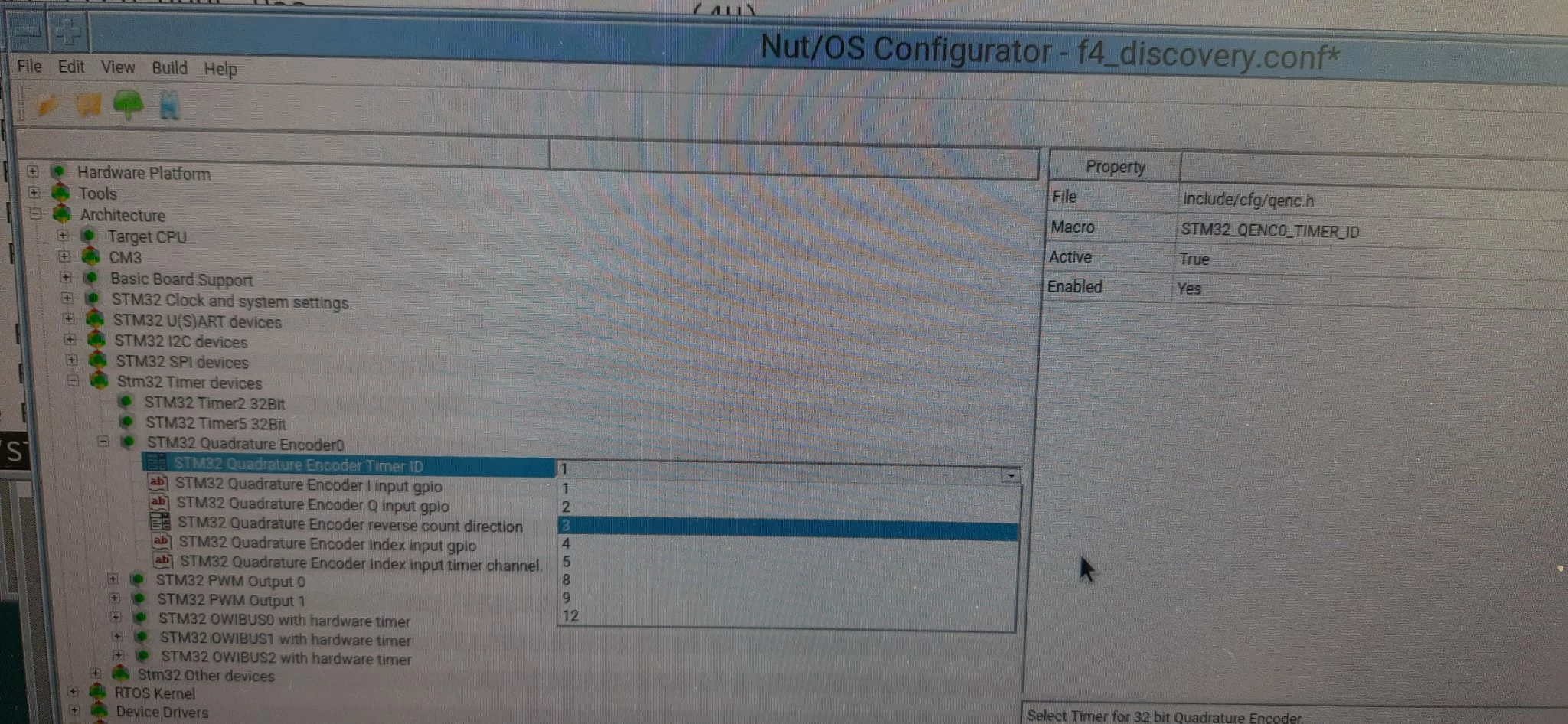

Well, F407 is not a recent family. Encoder mode need a time with two channels.WhatsApp Image 2024-02-19 at 12.08.52.jpegAt least there are timers 1/2/4/5/8/9/12 with two channels. If all channel gpios are available is another question.
waclawek.jan
February 19, 2024
Two channels is not a sufficient precondition. TIM9 and TIM12 don't have Encoder mode.
Only TIM1/8/20 and TIM2/3/4/5 have Encoder mode, across all STM32 families, as far as I know. Probably most if not all 'F1/'F2/'F3/'F4/'F7/'G4 and higher-end 'L4 (i.e. 'L47x and up) will have 5 timers with encoders; maybe also some of the 'G0/'F0, I did not check (I recommend against using the ancient 'F1 family, though).
Then, you have to choose a model which has enough pins so that all those timers do have CH1 and CH2 brought out on non-overlapping pins. I'd expect a 64-pin (xR) package, although the selection of higher families usually does not have lower pin-count packages anyway.
