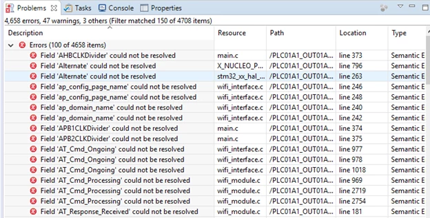

    Dave Bohan
    May 8, 2018
    Posted on May 08, 2018 at 15:31
    Here is revision data for the IDE:
    This is the directory I opened in the IDE:
    C:\plc\ac6Test3\STM32CubeFunctionPack_PLCWIFI1_V1.0.0\Projects\Multi\Applications\FP_IND_PLCWIFI1\SW4STM32\STM32F401RE-Nucleo
    I then did ''Build All'' and had errors in all projects:
    Here's a sample of the errors:
    And from the ''Console'' window:
    make: *** No rule to make target 'C:/Users/massimo oteri/Develop/X-Core-PLC01A1/Functional_Pack/STM32CubeFunctionPack_PLCWIFI1_V1.0.0/Middlewares/ST/STM32_LADDER_LIBRARY/Ladder_Lib.c', needed by 'Middlewares/STM32_LADDER_LIBRARY/Ladder_Lib.o'.  Stop.
    Thanks,
    Dave
    Andrea Palmieri
    Andrea PalmieriBest answer
    May 8, 2018
    Posted on May 08, 2018 at 16:30
    Hi Dave,
    here the problem seems to be related to the relative path of sources within the project tree in Eclipse. You should update your project by replacing the current links to sources with the ones in your working path.
    Hope that helps.
    Kind regards
    Andrea
    Dave Bohan
    May 8, 2018
    Posted on May 08, 2018 at 19:57
    Andrea,
    I found the references to 'c:/Users/massimo...' the the .project files and corrected them.  The project now builds!
    Is this a bug in the FP_IND_PLCWIFI1 project?  It seems incorrect to have hard coded paths inside of this project.
    Thanks,
    Dave
