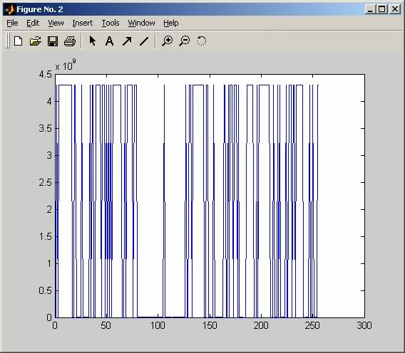

I'm trying to calculate FFT of this signal (using Keil uVision and STM32F103VB:
but the result looks like this:
Here's the code:
const int N=256;
void fft(){
int i;
uint16_t real[N], imag[N];
for(i=0; i<N; i++){
real[i]=(uint16_t)(data[i]);
imag[i]=0;
x[i] = (((uint16_t)(real[i])) | ((uint32_t)(imag[i]<<16)));
cr4_fft_256_stm32(y, x, N);
data is a float array containing the sine signal. Pictures above shows x and y arrays.
Could anyone tell me what I'm doing wrong?
Please help.

    You haven't given us much to work with here.
    From looking at your first plot, a sine wave with values 50 to 250, it would appear your input data might possibly be a series of int's. However you state:
        ''data is a float array''
    Is it really? Your code casts the input data to int's:
    (I'm assuming data[i] is the input data)
    If your input data is incorrectly declared as floats, that would be a problem.
    What is the function prototype for:  cr4_fft_256_stm32(y, x, N);  ?
    What are your definitions for y and x?
