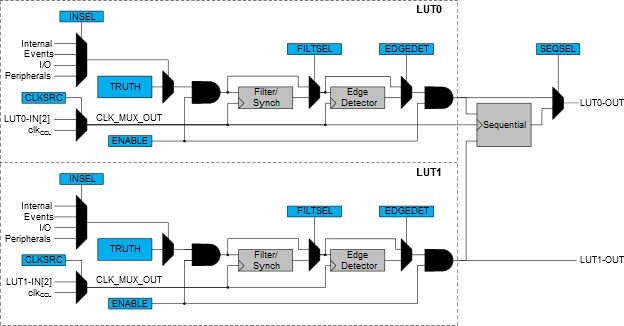

I am a fan of STM32, especially the peripheral sets offered are great. Over the years however, one type of peripheral is missing which would be a great help for many projects, this is a programmable logic cell.
Such a cell would contain elements like Flip-Flops, Look Up Tables and such that can be configured for specific functions. For instance using the LUT's, it would be possible to create all kinds of logic operations like AND, OR, XOR gates.
Using the Flip-Flops, I would be able for instance to create a clock gate, which I needed in my last project. There I needed an external clock signal to propagate to other peripherals and be able to enable/disable this. In the end I manage to create this function with a timer but this unfortunately generates something like 9 clock cycles of latency limiting the maximum frequency of the external clock signal. A basic Flip-Flop solution would probably introduce a much smaller latency.
Competing products offer this kind of functionality more and more, for instance the Microchip SAMD51 offers a Custom Logic cell which is highly programmable.
Such a peripheral would offer inputs and outputs that can be connected to other peripherals (GPIO, Timers and so on). Here I do see an issue since the Peripheral Interconnect of STM32 is not quite generic but very specific for the different types of peripheral. Another consideration would be to add so called hardware event channels to the STM32 which allow connecting almost any peripheral event output to another peripheral event input.
Well forgive me for starting to design, just adding the programmable logic would be really great for many control oriented applications.

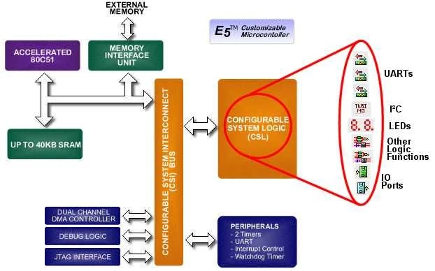

I remember the Triscend devices:
 https://antronics.co.uk/portfolio/csoc/
The tooling was, indeed, key.
And it did take a lot of support - someone had to help them: https://developer.arm.com/documentation/kan159/latest/

I found it really useful - being able to customise the peripheral set exactly to the application requirements.

Microchip have their CCL (Configurable Custom Logic) peripheral in some AVRs:
https://onlinedocs.microchip.com/pr/GUID-C866D457-41E2-43C7-8442-2F1193FAAD9F-en-US-4/index.html?GUID-BCB62DAC-D256-4F52-854F-36AFF54FDB3C

First of all, I am not suggesting to add something like an small FGPA but indeed, as many replicants noted, configurable logic like present in the Microchip ATSAMD51. STM32 MCU's are very good at things like motor control and communication but not soo for use with 'generic' control applications requiring all kinds of real time signals to react on and be generated in real time so by using peripherals and not software. The STM32 timers are great for this with IC/OC/PWM/Encoder and so on but not generic enough for the purposes I see. As such the suggested functionality is indeed just another peripheral. I think ST recognizes this too, look for instance at the new IRTIM peripheral in the STM32U5 range.
This is what I mean, be it that this is not generic in any way and targeting one very dedicated application, generating modulated IR signals using fixed timers.
Suppose now that the sources and the sinks for this gate and its functionality (AND, NAND, OR, NOR, ...) would be configurable........
The issue I see is whit the approach ST has taken to make connections between peripherals (The Peripheral Interconnect Matrix). Unfortunately this is not generic in any way. The connections that can be made between peripherals is dedicated and limited. It is not possible to just select a timer and let it trigger whatever other timer. The possibilities depend on the timer or other peripheral chosen.
When adding generic logic (like the Microchip CCL) with the current STM32 approach it will be very hard to define generic relations between this and other peripherals. Here too, the ATSAMD51 offers a generic approach with event channels. Almost any peripheral offers event sources and event sinks which are connected using one of the 32 event channels, which is just another peripheral.
