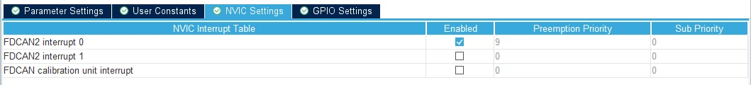

Of course the FDCAN2 interrupt 0 is activated on CubeMX :
What's wrong?

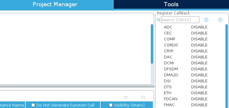

AScha.3
June 27, 2024
just ...
did you enable callback in Cube ?
in call back/int check, which fdcan is calling - you use 2 of them , so you need to know, which one is coming.
