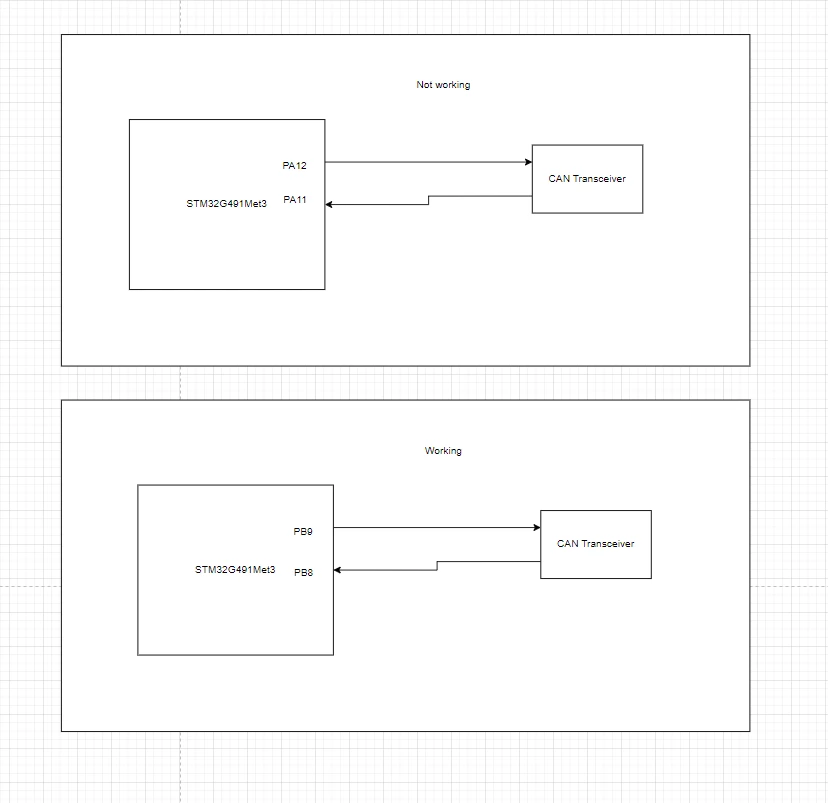

Meiko_JuAuthor
Feb 28, 2025 1:57 PM UTC
Originally we had fdcan1_tx on pa12 and fdcan1_rx on PA11 on the Can-Transiver. It did not work.
We then changed fdcan1_tx to pb9 and fdcan1_rx to pb8 using the StmCubeIDE. At the same time, we also re-soldered the corresponding channels of the transiver. The newly generated code now worked.
So I don't see a problem with our HW layout here.
The only difference I have noticed is that when debugging the first case, i.e. PA11 PA12, the fdcan interrupt is not called. When debugging the generated code with fdcan1 on Pb8 and Pb9, this is now called.
i hope the drawing helps to understand my problem.
Thanks again for your support
mƎALLEm
Feb 28, 2025 2:01 PM UTC
Unfortunately the sketch you attached doesn't help. Need the electrical schamatics.

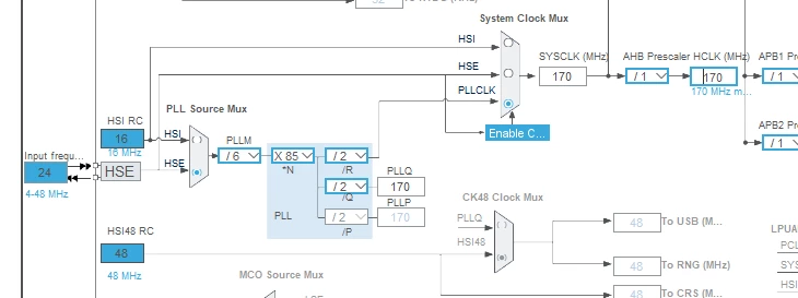

mƎALLEm
Mar 3, 2025 11:24 AM UTC
Also, please use the Crystal you have on the board for the CAN communication:
instead of the internal HSI (not recommended for CAN).
This is the new config:
