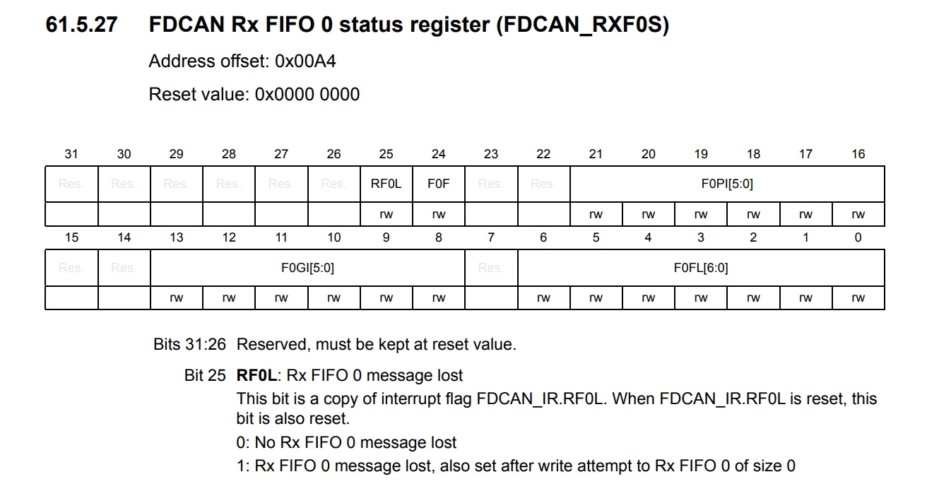

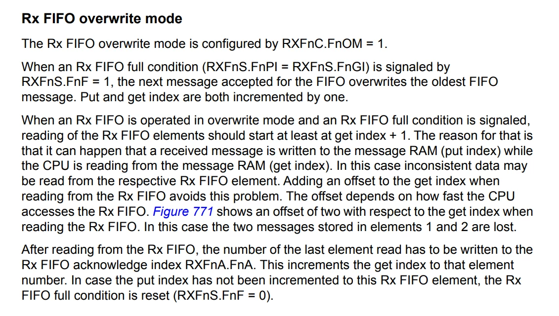

Is there a way to detect a CAN message loss in a RX Fifo when in the overwrite mode (so an overwrite?)

Yes over the FDCAN_RXF0S register / RF0L field:
From the reference STM32H723 reference manual (RM0468):
