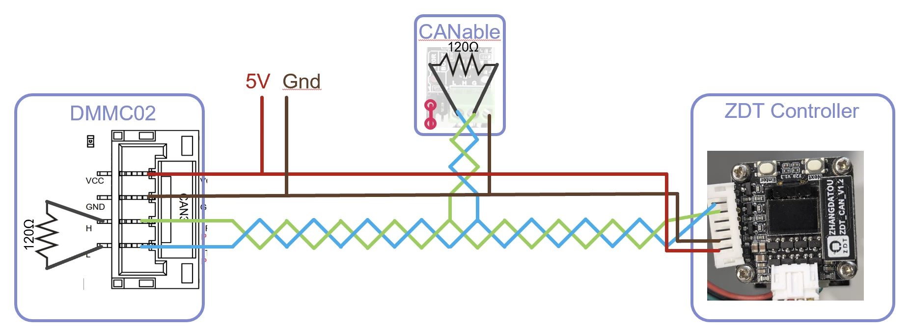

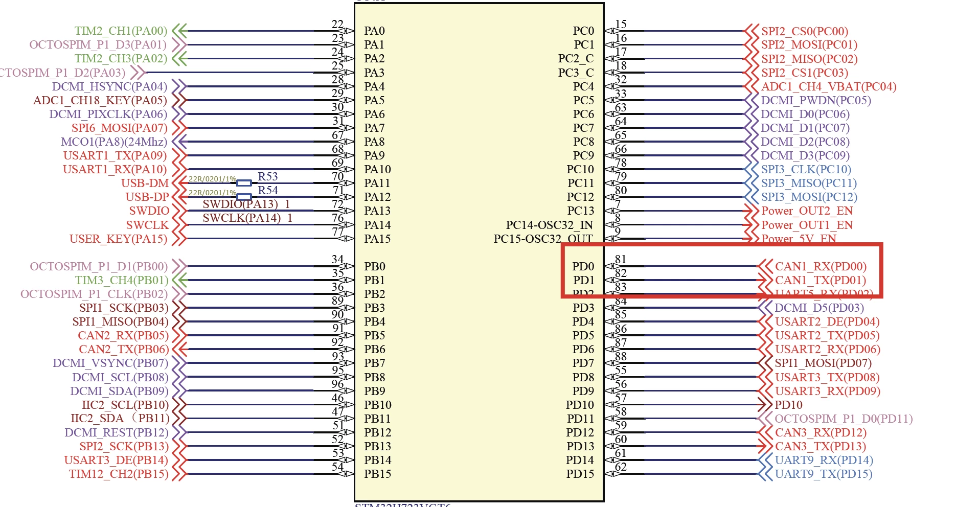

Hardware setup:

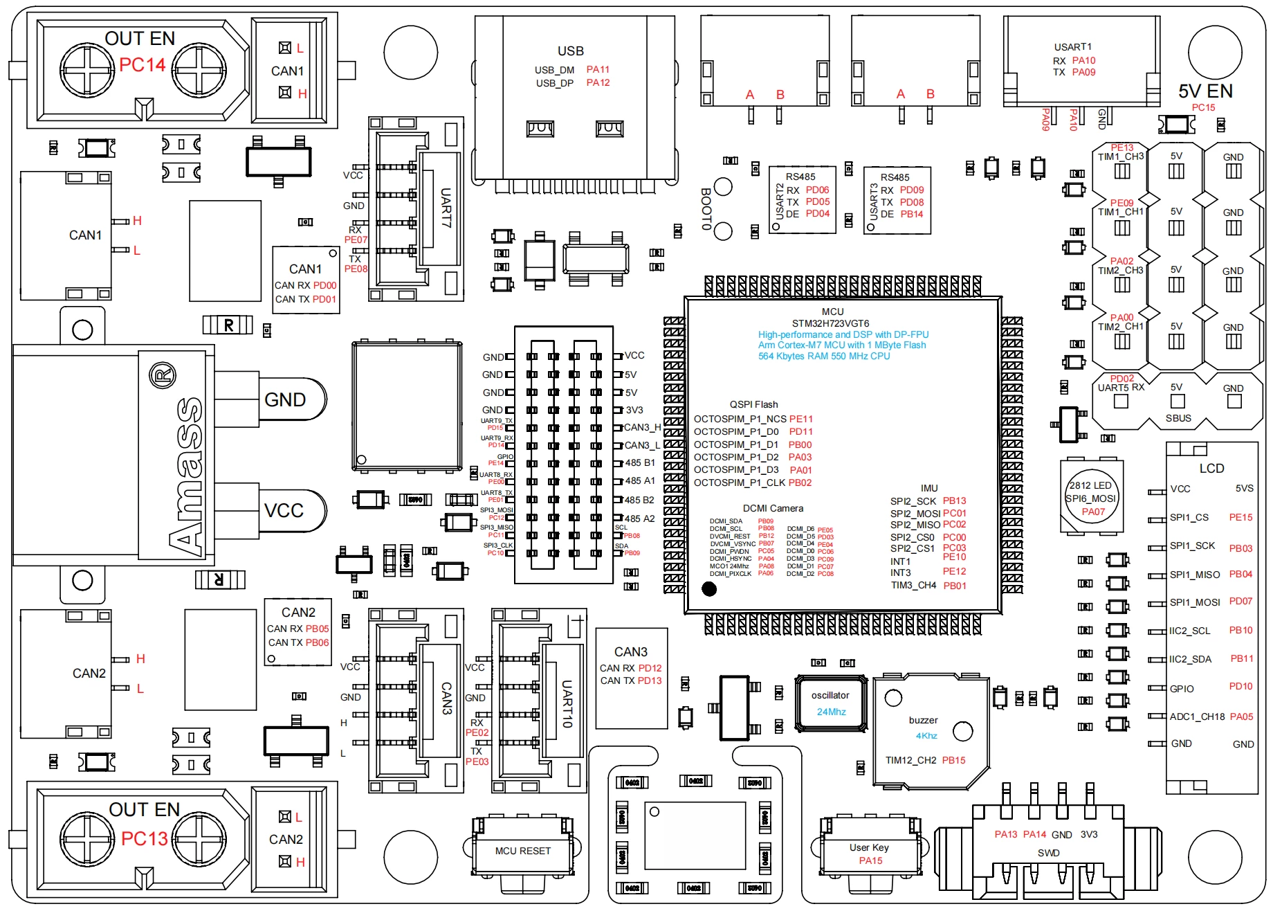

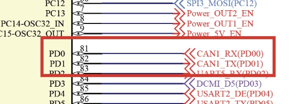

- DM-MC02 board, based on STM32h723vg (https://gitee.com/kit-miao/dm-mc02)

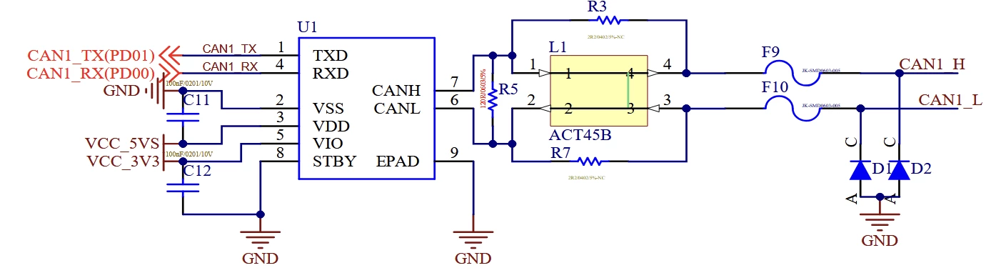

- SIT1042 CAN controller, directly built-in the board. Thus, the respective CAN_H and CAN_L are directly accessible through the board's pin
- (Device) ZDT_Emm_V5.0 stepmotor controller. Anyway it is just the device I am trying to send data to (https://blog.csdn.net/zhangdatou666/article/details/132644047)
- CANable 2.0 - inspired USB device.
What I am trying to do:
I want to be able to send and receive classical CAN messages using the DM-MC02 board to drive my controller. Because of my controller's specs, I need to send classical CAN messages with extended IDs at a bitrate of 500 000, by configuring FDCAN (what's supported by STM32h723vg) in normal mode. I would prefer using the CAN1 port of my board.
I am using STM32CubeIDE.
What works:
I am able to drive the stepmotor controller with my computer by using python-can through the CAN USB device, which indicates that for the most part my wiring seems okay, and that I do have a somewhat working CAN network. I did check the termination resistor values, all my CAN_H and CAN_L cables are twisted together.
What does not work:
My setup is rather simple, the CAN network is made of the DMMC board, CAN USB drive and the Stepmotor controller. For now, I wanted to send data from the board to the CAN USB (and see the messages via python-can or Cangaroo). However, I have no signal from my board.

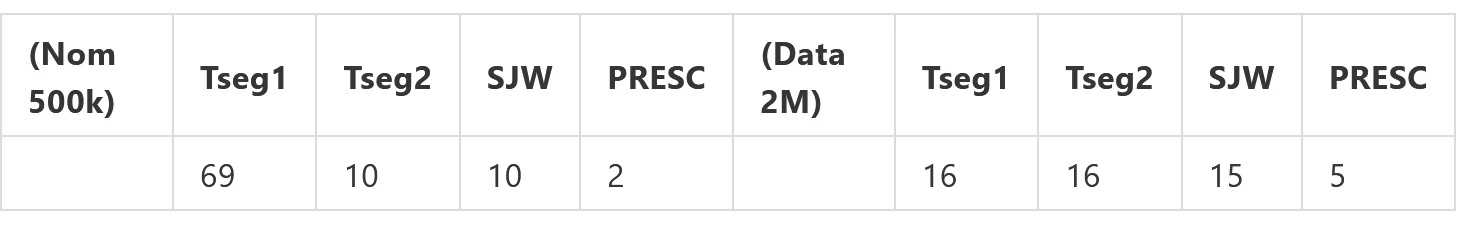

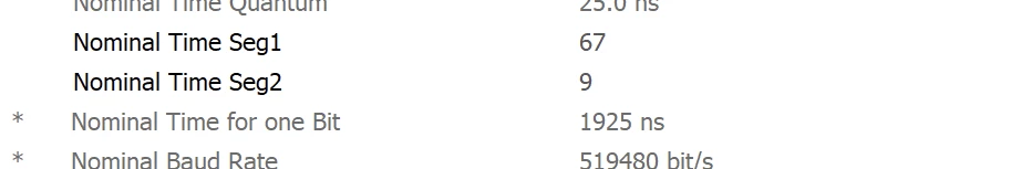

Basically I am unsure what is missing in my board's configuration or code. I have followed many guides to configure the .ioc, I even found some code by the manufacturer (not the settings I would like to use though, it is for FDCAN 1 250 000, which I am unsure what to think of by the way as, at least for python-can, 1 250 000 seem to be not a supported rate, thus I could not test with it much). For the timing configuration, I have used Kwaser's calculator for FDCAN, I found this configuration (from my understanding, the Data should not matter much with classical CAN) :

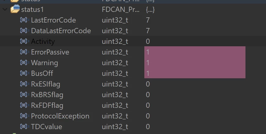

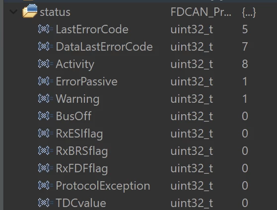

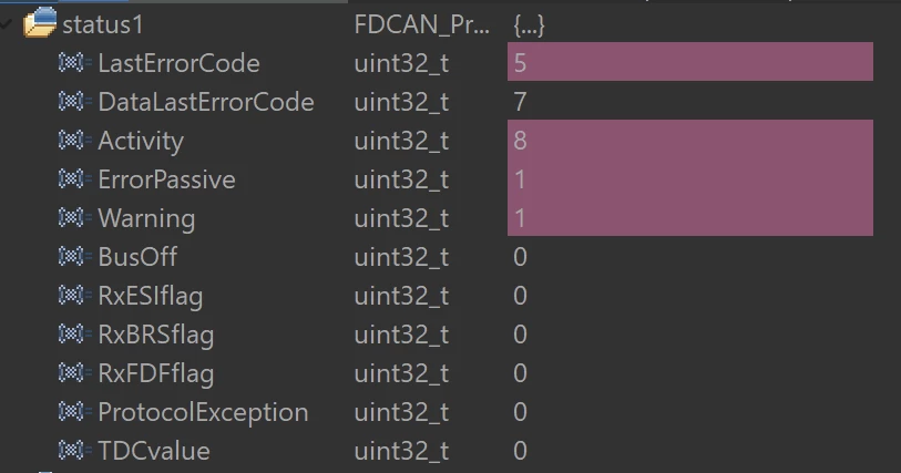

}Basically, I found that the code gets stuck in the while(HAL_FDCAN_IsTxBufferMessagePending(&hfdcan1, FDCAN_TX_BUFFER0) == 1) loop, indicating that the buffer has some difficulties getting processed and cleared.
When using "HAL_FDCAN_GetProtocolStatus(&hfdcan1, &status);", I can see that the status struct's DataLastErrorCode and LastErrorCode are set to 7 (No change since last read).
When trying to receive messages with a similar code, the program would also get stuck as if there were no new messages.
As I cannot make that simple setup work I am a bit at lost on what to do, perhaps the STM32 community could have new ideas.
