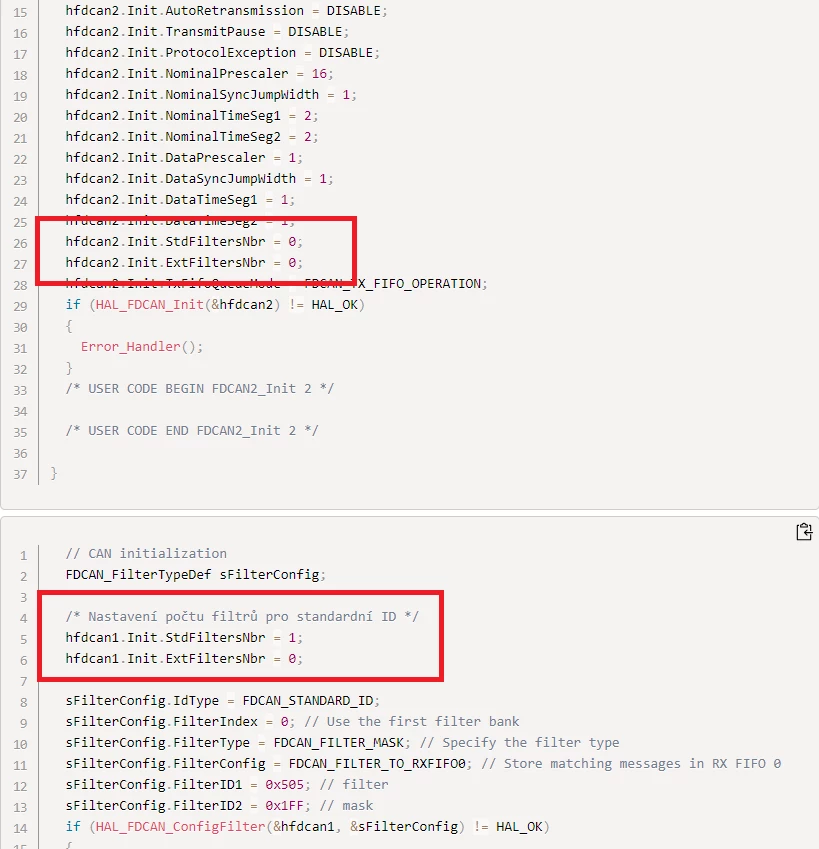

is there any simple example for (STM32G0B1CBT6) or similar where I can simply filter int genration for eg. only for 0x505 id in standart mode. I tested many samples and I believe that there must be some bug in IDE. This is

 hfdcan2.Init.StdFiltersNbr = 0;
 hfdcan2.Init.ExtFiltersNbr = 0;

 hfdcan1.Init.StdFiltersNbr = 1;
 hfdcan1.Init.ExtFiltersNbr = 0;

Where is the mistake whats wrong ?

But here again Standard filter number is set to 0! for both FDCAN1 and FDCAN2:
 hfdcan1.Init.StdFiltersNbr = 0;

Hello @JD3 ,
Your standard filter number is set to 0. Need to set it at least to 1.
JD3Author
September 23, 2024
I think it is set to 1 as iam not using extended id, using only FDCAN1:

Please review your original post:
Also there are two CAN instances used. You need to clarify exactly what is the problem and on which instance and need to share your code.

September 23, 2024
You've initiated for hfdcan2 but you're setting the filter for hfdcan1.
Or, you're not showing all your code.
