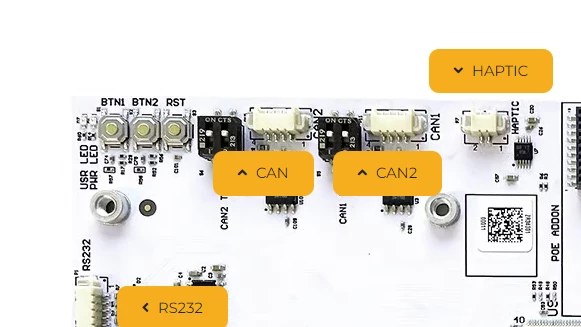

I've started to develop with the Riverdi STM32 Embedded Display and I'm trying to use the CAN BUS to display data, but unfortunately I can't. I'm not receiving any data. The CAN on the board is a FDCAN and I've set it to classic, because that's the function I need to use. I'm not receiving any data. The baud rate is set to 500kbit/s as I need it, but whatever I send to the board via the CAN BUS, I'm not receiving it. I need to receive from any CAN BUS ID. I'm also trying to find information on how to send data properly between the Main -> model. I've found some information but it's 2-3 years old and I could use a little more help.

Before going ahead with the code, is there a CAN transceiver on the board?
If yes, what is the node you've connected on the bus to transmit data to your board?
How did You connect CAN_H and CAN_L?
Is that possible to share your CAN schematics part? at least a diagram?

@mƎALLEm Their web page says: "Fully independent 2xCAN FDs  Applicable in industrial and automotive area."
https://riverdi.com/product/7-inch-lcd-display-stm32h7-frame-rvt70hssfwn00

Ok since the board features CAN transceivers, (and apart of previous questions) you need also to check the two termination resistors of 120 ohm connected to the bus.
Check also the wires continuity of CAN_H and CAN_L on the transceivers' pins.
