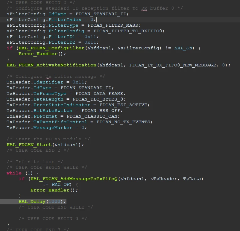

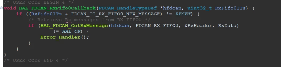

You are using Interrupts/callback, but you didn't activate the RXFIFO notification interrupt:
Add this line after HAL_FDCAN_ConfigFilter()
HAL_FDCAN_ActivateNotification(&hfdcan1, FDCAN_IT_RX_FIFO0_NEW_MESSAGE, 0);
And no need to activate this notification in the callback as you did:
void HAL_FDCAN_RxFifo0Callback(FDCAN_HandleTypeDef *hfdcan, uint32_t RxFifo0ITs) {
	if ((RxFifo0ITs & FDCAN_IT_RX_FIFO0_NEW_MESSAGE) != RESET) {
		/* Retrieve Rx messages from RX FIFO0 */
		if (HAL_FDCAN_GetRxMessage(hfdcan, FDCAN_RX_FIFO0, &RxHeader, RxData)
				!= HAL_OK) {
			Error_Handler();
		if (HAL_FDCAN_ActivateNotification(hfdcan,
		FDCAN_IT_RX_FIFO0_NEW_MESSAGE, 0) != HAL_OK) {
			Error_Handler();
Hareesh_SAuthor
September 16, 2024
I have made the changes you have pointed out, including a screenshot as I think it would be easier for you to access, given that I have not changed anything else. I am still not getting any data in my RXData buffer though.
I appreciate your patience in assisting me solve my issues,
Thank you!
mƎALLEm
September 16, 2024
First, please don't use screeshots to show your code. You need just to paste your code using </> button.
Second, unfortunately I don't have a STM32U5F7 board to test.
Try to change the filter config either:
By replacing:
sFilterConfig.FilterType = FDCAN_FILTER_MASK;
by:
sFilterConfig.FilterType = FDCAN_FILTER_DUAL;
 or keeping filter mask config and replace:
	sFilterConfig.FilterID2 = 0x11;
by:
sFilterConfig.FilterID2 = 0x7FF;

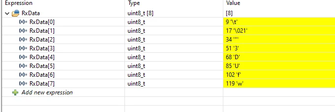

Just tested the project on a compatible MCU (on STM32U5G9 DK board) I've just adapted the value of crystal 25MHz -> 16MHz and it's working perfectly. The Rx callback is raising and the data are receiving very well.
This is the Live Expression and as you can see the value is updating. Just added the incrementation of the first data TxData[0]:
See attached project. So need to check again from your side.
Hope I answered your question.
