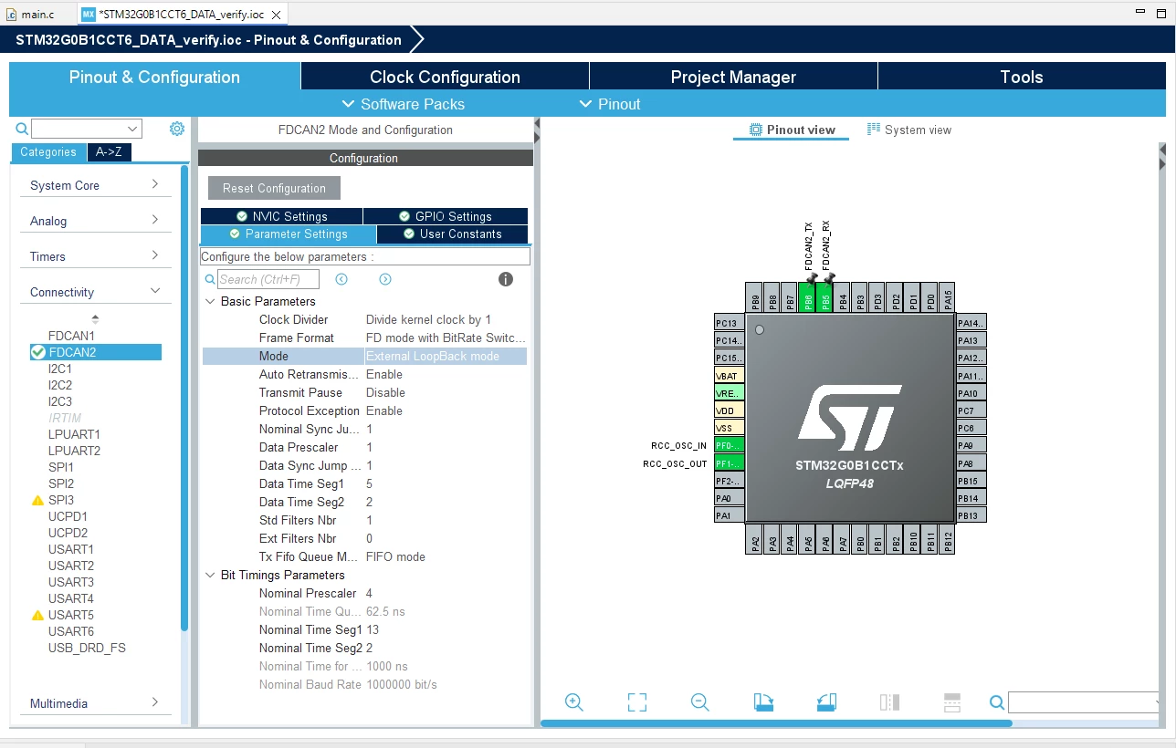

I am working on FDCAN communication using an STM32G0B1CCT6 microcontroller. I am trying to perform a simple Tx/Rx loopback test (and later communication with external tools like Vehicle Spy), but I am facing the following problem:
  • FDCAN is not transmitting or receiving any message.
  • I have configured the peripheral in Normal mode with the following settings:
    • Clock: 64 MHz
    • Bitrate: 1 Mbps
    • Prescaler: 16, TimeSeg1: 13, TimeSeg2: 2, SJW: 1
    • Frame Format: Classic CAN
    • Auto-Retransmission: Enabled
  • I also added a filter (Filter 0) to accept all standard IDs into RX FIFO 0, but still no data is received.
  • FDCAN init and message send/receive functions return HAL_OK, but no actual communication happens on the bus.
I’ve verified the transceiver wiring (ISO1044), and I'm testing using Vehicle Spy and ValueCAN4. I’ve also tried internal loopback, but still no response.

Thank you for the response. To clarify, I have tried both Loopback and Normal mode for FDCAN on my STM32G0B1CCT6, but unfortunately, neither mode is working.
  • Loopback Mode: I set the FDCAN in internal loopback mode, expecting the device to send and receive its own message. However, no data is being transmitted or received.
  • Normal Mode: I also tried normal mode with the correct clock settings, prescaler, and bitrate, but again, no communication happens.
I have verified the transceiver wiring and am using a ISO1044 transceiver, and I am testing with ValueCAN4. But still, there is no TX/RX communication happening.
Can you please share any relevant STM32CubeMX FDCAN settings or suggest what could be missing from my configuration?

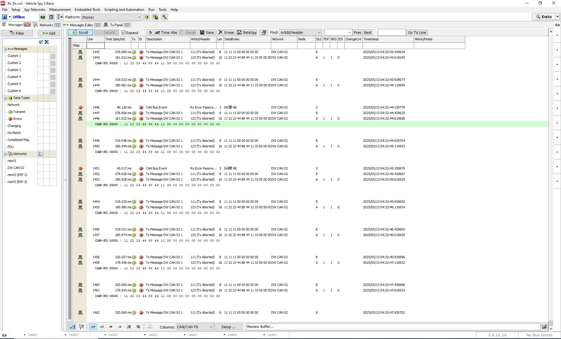

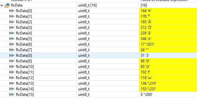

I had initially set hfdcan1.Init.StdFiltersNbr = 0, as you mentioned. After updating it to at least 1 and properly configuring  now I am able to receive the message in External loopback mode — so yes, reception is now working.
However, transmission is still not successful.
  • I checked the CAN Tx pin with a logic analyzer, and during transmit, there is no activity.
  • I also checked voltage on CANH and CANL lines with respect to GND — both show ~2.5V, which is correct in idle state?
  • I have attached:
    • My STM32CubeMX configuration screenshots
    • The code used
    • A screenshot from Vehicle Spy, which shows error during transmit
  • I am using Standard ID (11-bit) and ISO1044 transceiver, with proper 120Ω termination.
So now I request support to understand why the Tx is failing. Any further suggestions would be really helpful.

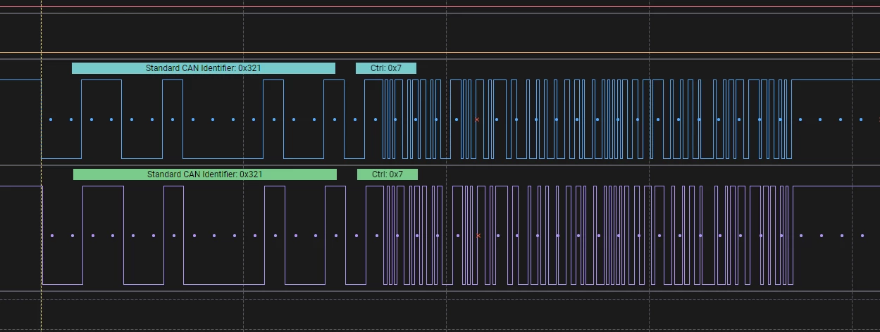

I used your project with a little modification, I can see the frame on Tx pin as well as on Rx.
I used two NUCLEO-G0B1RE boards connected with two transceivers. The same example uploaded to the two boards.
This is what I can see with a CAN analyzer: Blue: Tx, Purple: Rx.
I'm also seeing the message received, which are sent by the other board:
So, either there is something transmitted on Tx but there is an issue with your logic analyzer configuration or you have something on your hardware. So check all your connections, check the GPIO pins used etc..
PS in Normal mode we recommend to use an external crystal instead of using HSI or any internal RC source.
I've attached your project with the modification.
