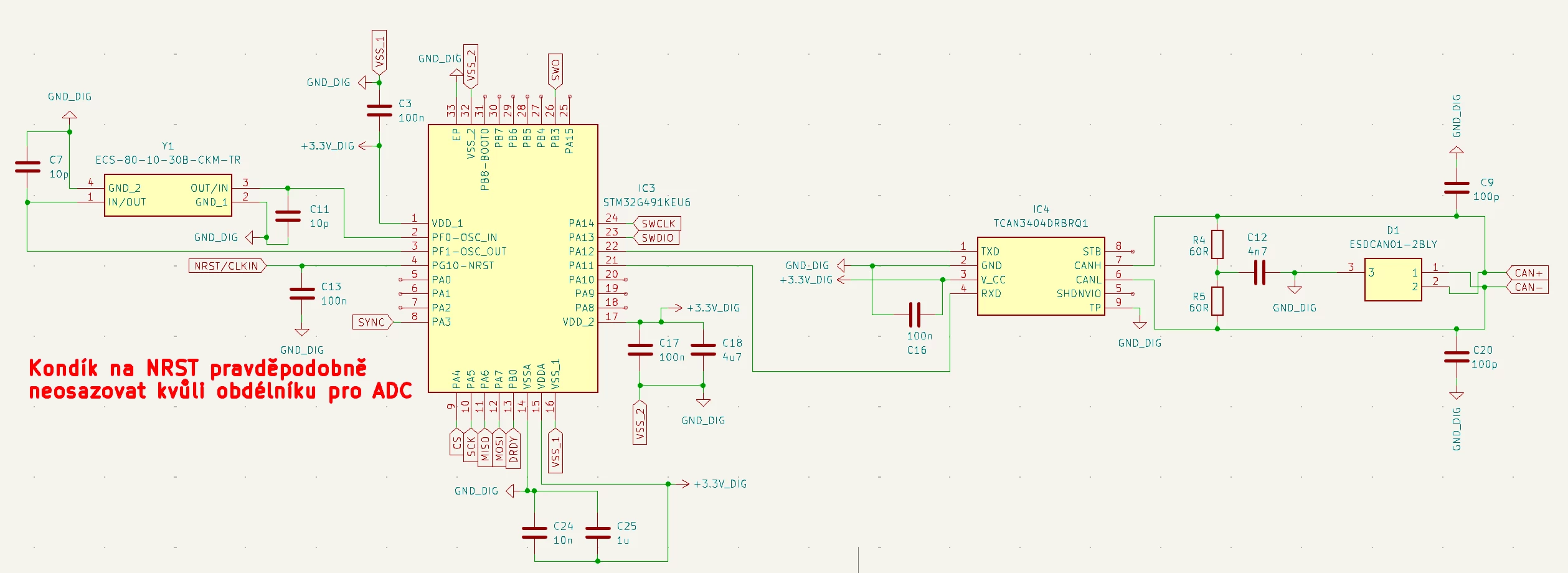

I am trying to use a STM32G491KEU6 with FDCAN, but the communication is failing at line:
if (HAL_FDCAN_AddMessageToTxFifoQ(&hfdcan1, &TxHeader, TxData) != HAL_OK) { ...
I found out that this is a problem that receiver is not sending a ACK bit - cannot it be a software issue? I am using two STM32G491KEU6 with the same code mentioned bellow, while I am also using a TCAN3403DRBRQ1 transceiver on both boards.
The boards seems ok, I can even see a transmittion on the line with oscilloscope, but there is probably no ACK.
Thank you for any help

Ahh, I found the issue... CAN LOW differential had short circuit to GND - bad soldering. Thank you for your time.

For CAN/FDCAN subject especially when using Normal mode you need to provide more details especially the HW part. So please share schematics.
Also, I recommend to use HSE with an external crystal instead of HSI.

I am sending a schematic. In my PCB, there is also a GND on pin 8 STB (by datasheet, this should allow normal mode instead of standby mode).
Thx for that recommendation.

Could you please share your ioc file?
Chenge FrameFormat to FDCAN_FRAME_CLASSIC;
Could you also please state on Y1? could you please share its datasheet?
