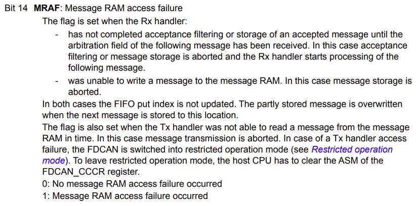

I'm experiencing FDCAN Memory Access Failures on the STM32H503KBUX during CAN Rx.
I am also experiencing intermittent CAN Rx message drops (every 1 in a 200), and I believe the two are related since no others errors are firing. I know the drops are happening on the STM32 because I can see the messages on the bus with my CAN debugger and there are no error frames.
I'm struggling to understand why this Memory access error is happening and how to proceed with solving it. The only info I can find is in rm0492. However, it doesnt really say what might cause these events to happen.

Best answer by dnugent
I found the issue. It was a slow clock speed issue.
The FDCAN peripheral has 2 clocks: the FDCAN kernel clock controls the bit timing and APB1 controls the RX handler (and other stuff). It was the APB1 clock being too slow and not running the acceptance filter fast enough. It was clocked at 32Mhz so I upped it to 128Mhz and that fixed the issue.
I did end up keeping FDCAN kernel clock at 100Mhz because we have other projects running at this speed so I kept it high.
