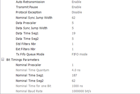

mƎALLEm
mƎALLEmBest answer
October 18, 2024
First, you don't need a transceiver in the Loopback mode.
Second, as you are in Classic mode, these parameters are wrong for transmit as these are for FDCAN.
txHeader.DataLength = FDCAN_DLC_BYTES_12;
txHeader.BitRateSwitch = FDCAN_BRS_ON;
txHeader.FDFormat = FDCAN_FD_CAN;
So you need to use these parameters instead:
 txHeader.DataLength = FDCAN_DLC_BYTES_8; /* maximum 8 bytes*/
 txHeader.BitRateSwitch = FDCAN_BRS_OFF;
 txHeader.FDFormat = FDCAN_CLASSIC_CAN;
Please refer to this example on Github:
https://github.com/STMicroelectronics/STM32CubeH5/blob/main/Projects/NUCLEO-H563ZI/Examples/FDCAN/FDCAN_Classic_Frame_Networking/Src/main.c
PS: only Tx pin can be probed with your analyzer.

mayank__Author
October 18, 2024
Do not have any idea about configuring seg 1 and seg 2. Please can you provide brief information?
I am not sending message to any other node right now. Will be verifying the data using Logic Analyzer for successful transmission.
APB1 frequency is 250 MHz, CAN Frequency 8 MHz, Current baud rate 166666 bit/s and do not require any specific baudrate right now just trying to successfully transmit a data first of all.

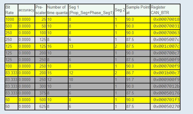

mƎALLEm
October 18, 2024
@mayank__
 My doubt is confirmed. So you didn't setup any CAN bus. CAN is not UART or SPI to test it in "standalone" when it's configured in Normal mode. You need to configure it in one of the Loopback modes (Internal or External).
But since (I think) you need to visualize frames with a Logic analyzer, use External Loopack mode and probe the signals on FDCAN_Tx.
Modify the bit timings as I described previously.
Hope I answered your question.
mƎALLEm
October 18, 2024
Hello @mayank__ ,
First, as you are using normal mode:
 hfdcan1.Init.Mode = FDCAN_MODE_NORMAL;
Could you please provide more details on the CAN bus: nodes connected to the bus, your HW setup including the transceiver?
Second: these are bad timing parameters SEG1=1 and SEG2=1. You need to increase these values as much as possible and decrease the presale as much as possible to increase the bit time sampling rate where SEG1 =~(75% to 85%) of the bit time:
 hfdcan1.Init.NominalPrescaler = 16;
 hfdcan1.Init.NominalTimeSeg1 = 1;
 hfdcan1.Init.NominalTimeSeg2 = 1;
 And based on what you provided as information, I have a doubt you are using the FDCAN in "standalone" i.e. you didn't setup any CAN bus: no transceiver, no nodes connected to the bus which is not the correct setup as FDCAN is in normal mode.
Please clarify all these points.

http://www.bittiming.can-wiki.info/
You need to have a second CAN node to transmit to and you need a proper CAN bus termination with the 120Ohm resistor on each end. Or you have to set the CAN controller to loopback.
If a reply has proven helpful, click on Accept as Solution so that it'll show at top of the post.CAN Jammer an open source CAN bus hacking toolCANableV3 Open Source

I have applied changes to my code by referring to Loopback Sample Code of STM32 and connected STM32 to a Tranceiver. I am using Classic Mode and Normal mode as configurations and below image for configurations
But the Loopback sample code is giving some transmission signals on logic analyzer
Still not able to get anything on the logic analyzer, both TX and RX stays high all the time not getting any data transmitted. Please refer to the below code
