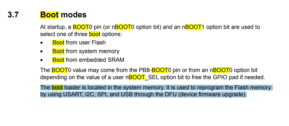

Hello @Savan_Sutariya
According to the AN2606 and DS12288, the boot loader is located in the system memory. It is used to reprogram the Flash memory by using USART, I2C, SPI, and USB through the DFU (device firmware upgrade):
So, the FDCAN is not an option.
Best Regards.

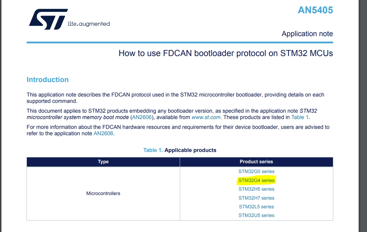

May 27, 2024
Hi @STTwo-32
Thank For fast Reply,
but According to AN5405 , STM32G4 series is supported for FDCAN bootloader.
Best Regards,
Savan Sutariya
STTwo-32
May 27, 2024
The AN5405 is for both Bootloader and open bootloader which is supported by the STM32G4 series. But the Bootloader is not available on STM32G4 series devices.
Best Regards.
