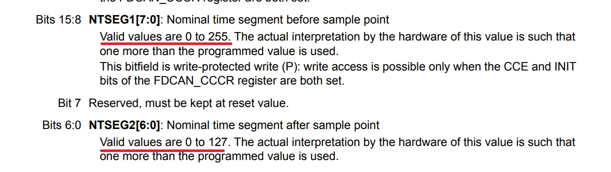

This is a known issue in the FDCAN spec and it was already internally reported on the ticket 193478.
From the reference manual RM481/page 2575:
page 2571:
The correct bit times:
For Nominal bit time:
- NTSEG1: between 1 and 256 (* tq)
- NTSEG1: between 1 and 128 (* tq)

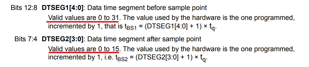

For Data phase bit time:
- DTSEG1: between 1 and 32 (* tq)
- DTSEG2: between 1 and 16 (* tq)
So the example is correct.
As you are using Classical frame you need to set only the Nominal bit time.
Hope that answers your question.

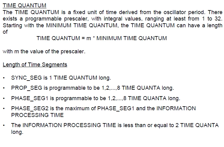

For Classical CAN I don't understand how max values for NTSEG1 and NTSEG2 can be so high:
- NTSEG1: 256 (* tq)
- NTSEG2: 128 (* tq)
I attach a screenshot from document "BOSCH CAN Specification version 2.0".
In this document max values expressed in tq are smaller.
Also "Controller Area Network Konrad Etschberger" book page 82 confirm these limits.
For sure my fault, but I don't understand.

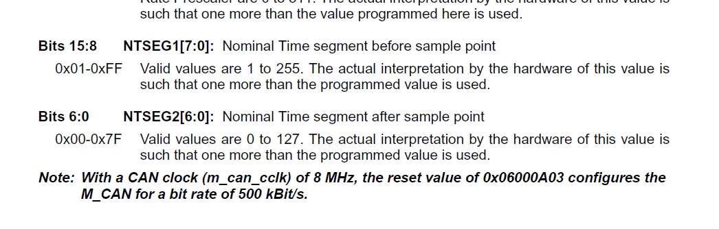

mƎALLEm
Mar 24, 2025 3:44 PM UTC
I don't know which Bosch spec you get that screen shot from, but you need to refer to the M_CAN.
This is a screenshot from BOSCH M_CAN spec (page 23):
