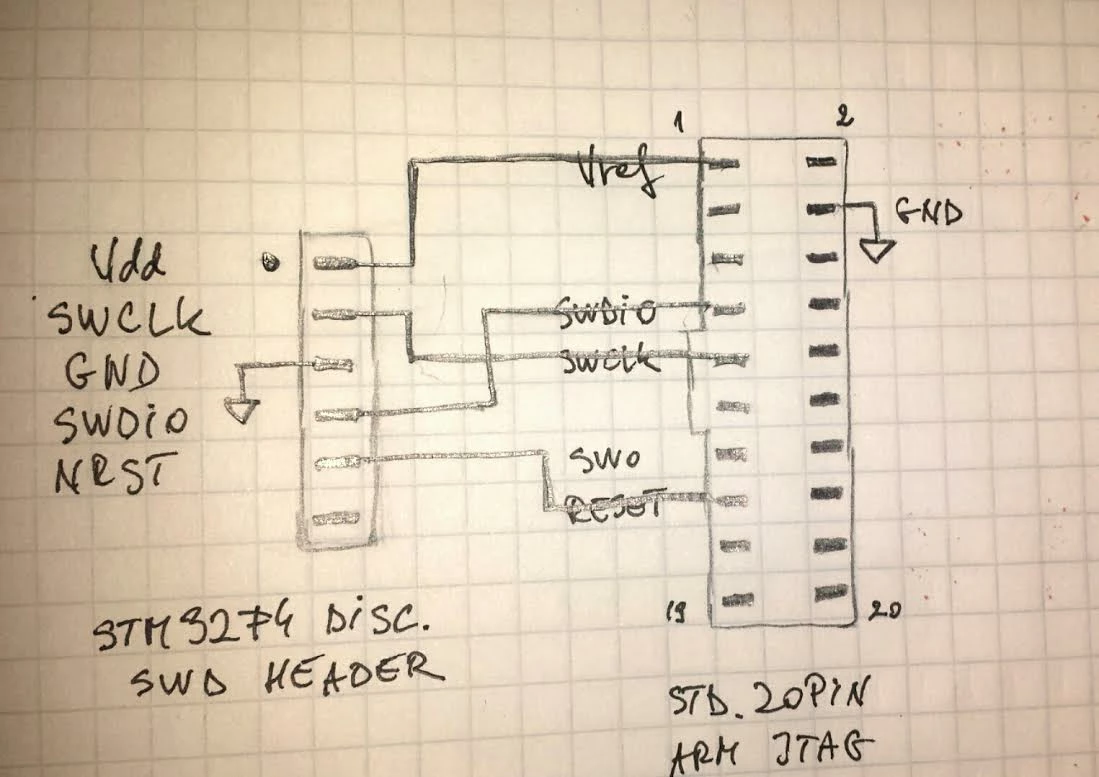

I bought the fcu001v1, the device just started to blink of led LD2 and LD1 off, i tried searching for bluetooth connectivity. device was not listed.
i tried to connect the SWD of FCU001V1 through my STlink V2 on STM32F4 Discovery, but device is not detected.
does the micro usb port configured as USB device for DFU firmware update ? it is not detected as USB device on my PC.
Please help......
i followed this connection
