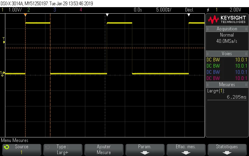

I measure the time between TESTA11_OFF-TESTA11_ON.

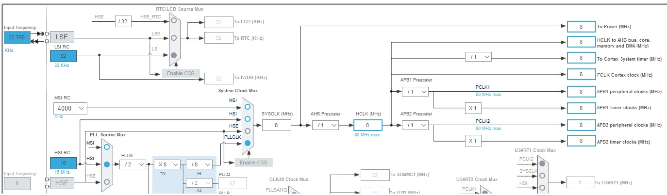

For the 8MHz configuration:
CubeMx sets : LL_FLASH_SetLatency(LL_FLASH_LATENCY_0);
The processing time is 6.28ms

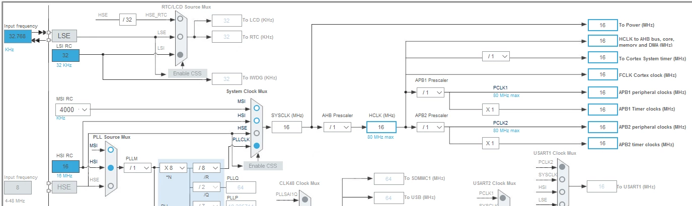

I change the configuration to 16MHz by CubeMx:
The processing time is always 6.28ms.

If I do not set the STM32L476 in stop mode 2 when CPU not busy I have:
8 MHz: processing time: 12.56ms
16 MHz: processing time 6.28ms
80 MHz: processing time 1.26ms.
At 8 or 80 MHz, why the processing time of a function which lasts many ms depends of the stop mode 2 when the CPU is not busy?
At 8 MHz, why the processing time is faster when the CPU enters the Stop Mode 2 while inactive?
