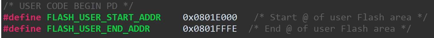

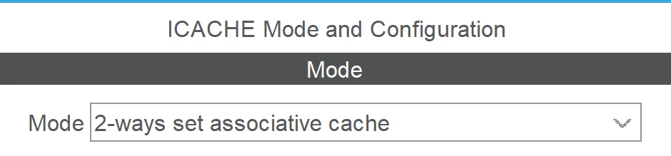

March 14, 2025
Thank you, it helped me to clearly indicate the beginning and end of the memory address and setting 2 ways ICACHE; when setting DIRECT MAPPED CACHE, saving occurred with an error
