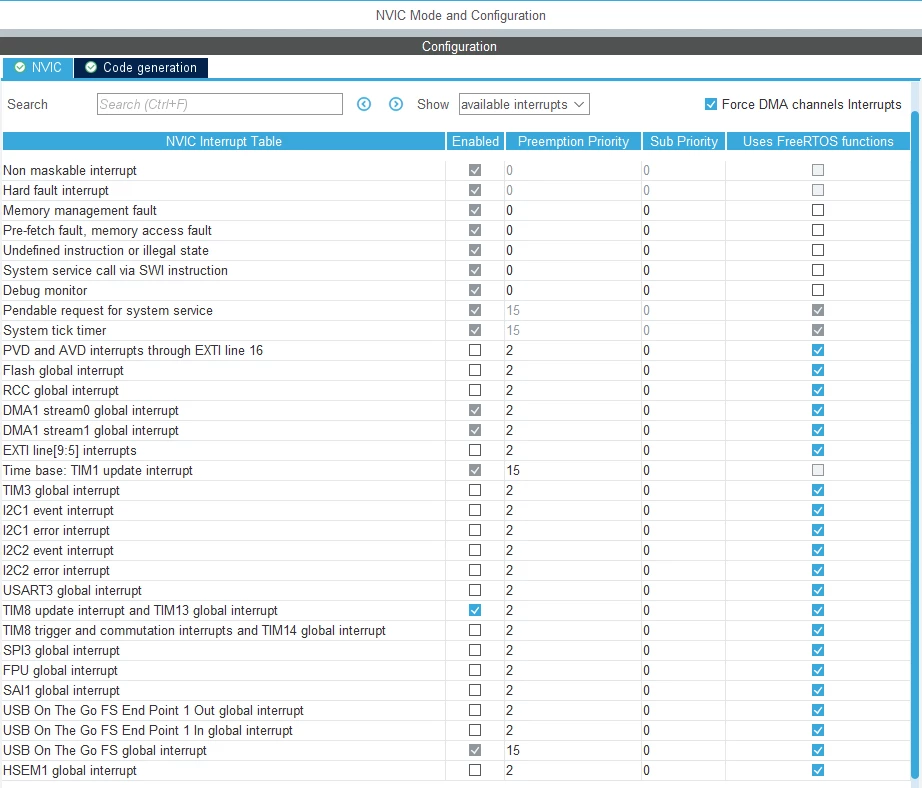

However, when I am just listing the files (not even reading or loading files) using FatFs on the STM32 while audio processing is running I get random garbage every second to fifth time I read a directory. So, the data rate is really low. When I stop the SAI DMA it's 100% reliable as well.
And these are my NVIC settings:
Thanks!
AScha.3
November 13, 2023
its late now...but in brief : your problem is int priority.
ie. i have on H743 (and now on H563 beginning) an audio player running. :)
read from SDcard or USB stick, data out with SAI /DMA circular (same you, almost); with FatFS.
when playing cd audio 44/16 , cpu load is about 3% ; with FLAC file at 96k and 32bit also no problem, cpu still under 40% load; and decoder + 2x biquad filter (double precision) needing most time here, cpu at 200MHz clock, to run cool.
so "play" with your int priorities ! all on same level is nonsense.
try: usb 4 , DMA 9+10, tim so important? if not, 12.

@AScha.3
I don't understand how interrupt priorities could be the issue here. But I tried what you suggested and also tried different combinations. No success. SPI communication with the W25Q128 is not in interrupt mode. I disabled the timer, it's not needed anyways. USB enabled or completely removed makes no difference either. Also, since a lower number means higher priority, wouldn't it make more sense to keep the DMA interrupts low around 2 (= high priority) as these are the most important and time critical thing? And set the USB to a high number (= very low priority) since it is not time critical at all?
