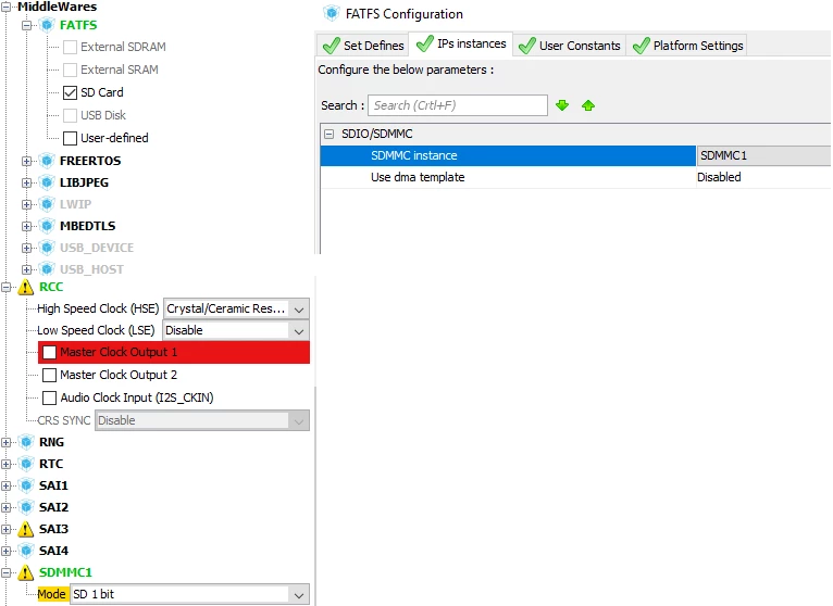

So i try with the Cube to implement the SDMMC (1bit bus at the moment) and FatFs interface for an SD card. (configuration of the Cube on attachement).

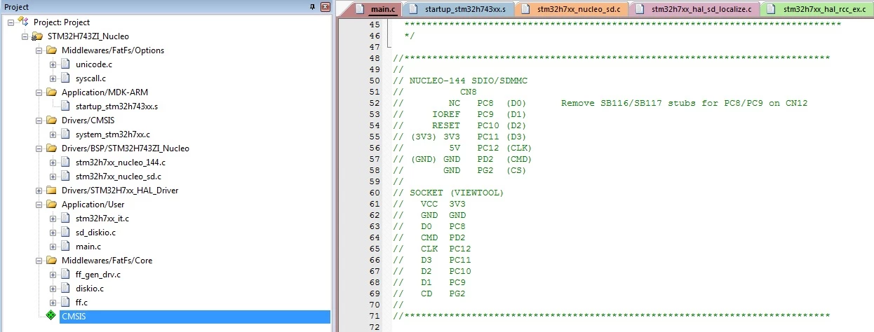

    My approach has been to port the HAL code from the STM32H743xI-EVAL board to the NUCLEO-H743ZI, creating a stm32h7xx_nucleo_sd.c

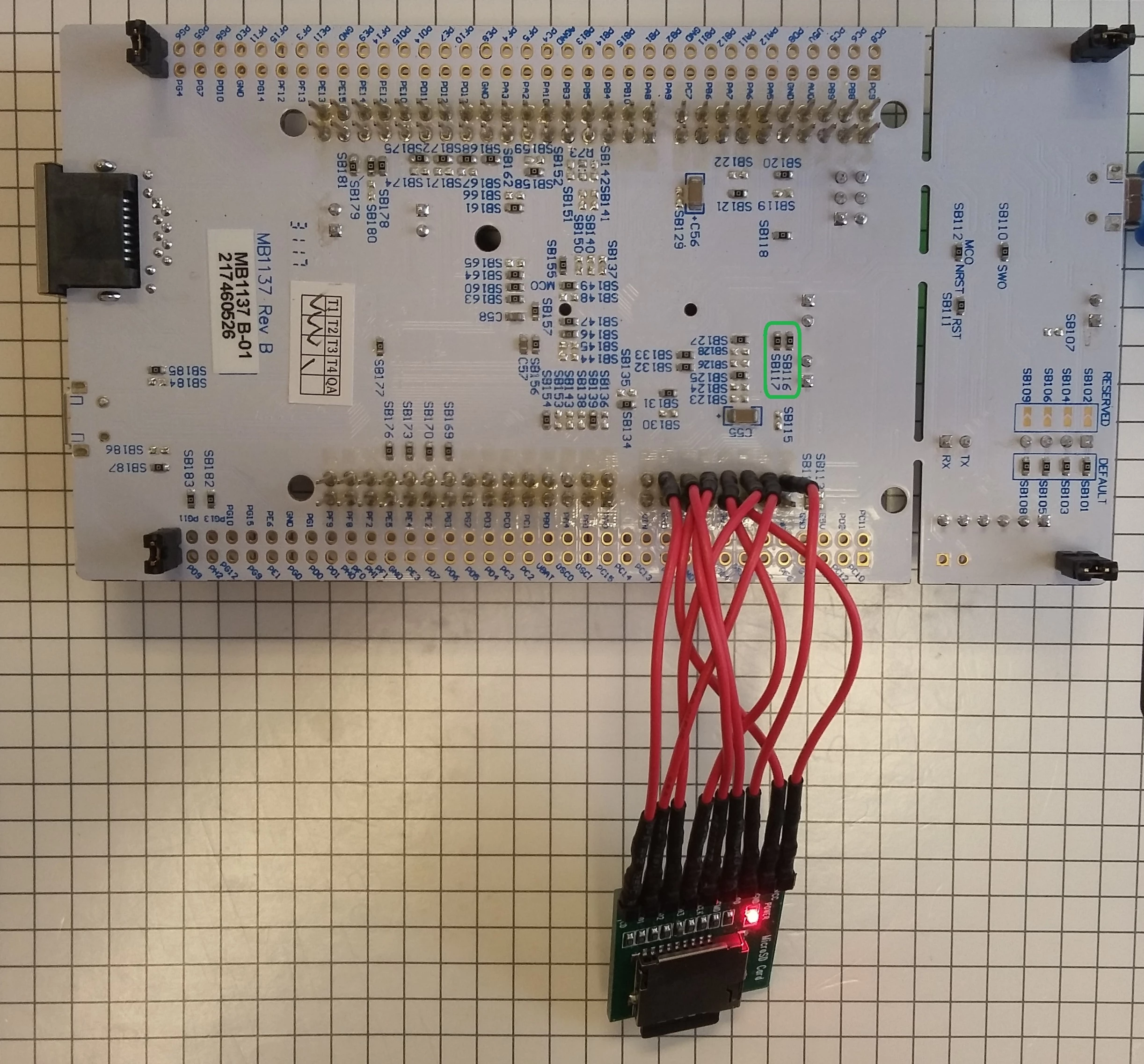

    So far, the pinout i'm using is OK.
    I can say that because my SD card is answering me.
    The command BSP_SD_IsDetected() provided by the cube is working
    it returns me 1 if there is an SD card and 0 if there is none.
    Second point that can confirm what i'm saying is that f_mount(&SDFatFS, (TCHAR const*)SDPath, 0) answer me 'FR_OK'
    I dig up a few an come to f_open(&SDFile, 'STM32.TXT', FA_CREATE_ALWAYS | FA_WRITE). but this one is not working. Indeed, i code the answer
    FR_NOT_ENABLED
    Note : &SDFile is declared like so : 'FIL SDFile'
    And ... well  i have no clue at the moment why it's not working ...

    Is your FatFs built as read-only?
    ffconf.h
    ♯ define _FS_READONLY 0
    /* This option switches read-only configuration. (0:Read/Write or 1:Read-only)
    / Read-only configuration removes writing API functions, f_write(), f_sync(),
    / f_unlink(), f_mkdir(), f_chmod(), f_rename(), f_truncate(), f_getfree()
    / and optional writing functions as well. */

    two things in one!
    First of all, it works like a charm! (some issue about permissions but that's not a big of a deal now!)
    I remove as mentionned before the '0ohm' resistor on pin SB116 and SB117
    and ... well it makes things work!
    if also changed a bit two functions :
    • FATFS_LinkDriver(&SD_Driver,(TCHAR const*)SDPath)
      FATFS_LinkDriver(&SD_Driver,'')
    • f_mount(&SDFatFS, (TCHAR const*)SDPath, 0)
      ->f_mount(&SDFatFS, '', 0)
    I keep things simple here to start understanding how things work!
    thank you Clive for the help you provide me!
    And for the others who would like to make the same stuff work, here is an easly understandable code!
