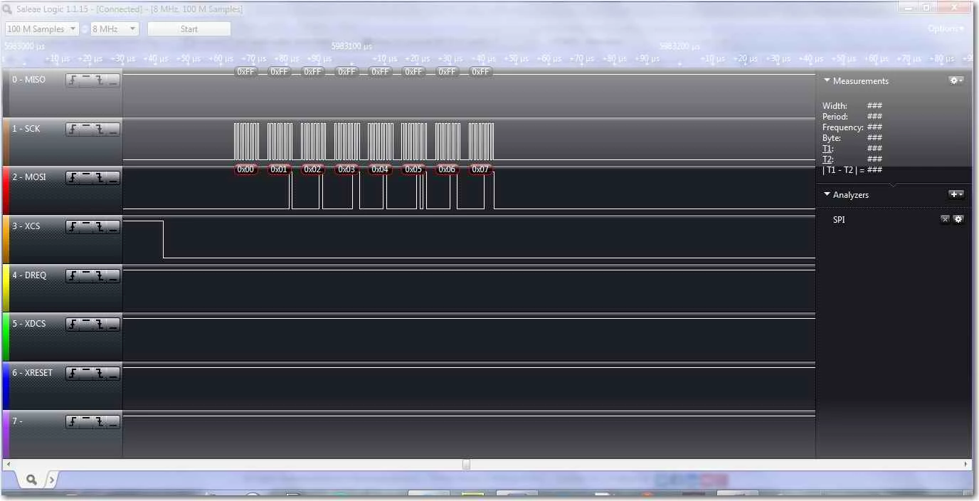

    Posted on February 02, 2016 at 21:56
    I can get DISK connected fatfs.c Line 48!    On My serial but nothing in my Logic analyzer....where do I miss here ?   I don't understand until this point....??   void MX_FATFS_Init(void)

    SPI2 test is working OK !
    as I can see on logic analyzer Code :
    HAL_GPIO_WritePin(GPIOB, GPIO_PIN_10 , 1 );
    HAL_Delay(100);
    HAL_GPIO_WritePin(GPIOB, GPIO_PIN_10 , 0 );
    uint8_t data1[8] = { 0x00,0x01,0x02,0x03,0x04,0x05,0x06,0x07 };
    HAL_SPI_Transmit(&hspi2,data1,8,1000);
