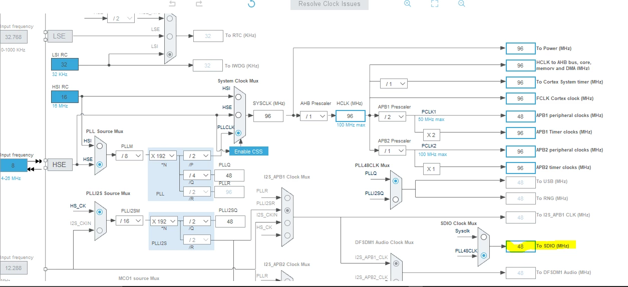

August 14, 2024
Just adding some additional MCU configuration settings:
 * @brief SDIO Initialization Function
 * @PAram None
 * @retval None
static void MX_SDIO_SD_Init(void)
	/* USER CODE BEGIN SDIO_Init 0 */
	/* USER CODE END SDIO_Init 0 */
	/* USER CODE BEGIN SDIO_Init 1 */
	//ToDo: Ensure hsd.Init.BusWide = SDIO_BUS_WIDE_1B;
	/* USER CODE END SDIO_Init 1 */
	hsd.Instance = SDIO;
	hsd.Init.ClockEdge = SDIO_CLOCK_EDGE_RISING;
	hsd.Init.ClockBypass = SDIO_CLOCK_BYPASS_DISABLE;
	hsd.Init.ClockPowerSave = SDIO_CLOCK_POWER_SAVE_DISABLE;
	hsd.Init.HardwareFlowControl = SDIO_HARDWARE_FLOW_CONTROL_DISABLE;
	hsd.Init.ClockDiv = 6;
	/* USER CODE BEGIN SDIO_Init 2 */
	/* USER CODE END SDIO_Init 2 */
I'm using the SDIO peripheral in 4 bit wide mode but I found that initialising as 1 bit wide works and reverting back to 4-bit works:
https://community.st.com/t5/stm32cubemx-mcus/sdcard-does-not-work-with-4bits-wide-bus/td-p/602607
