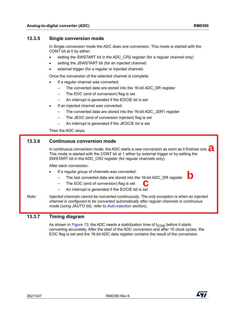

I want to permanently sample ADC data with an ST32F466. Timing is not important, so the idea is to do that out of the main loop. So my idea is, whenever there is some time and whenever the main-loop reaches the related position in code, it reads out the related data register of the ADC and then uses it. When the ADC is not yet ready - no problem, the main-loop will try later when it reaches that position again.

So my question: is there a way to set the ADC into a mode where
  • it permanently samples data from the related input once it has been initialised
  • writes the converted data into a register where the application can read it from
  • sets a "ready"-bit so that the main application can see there is a new value that can be read out of that data-register?

> ST32F466
Do you mean STM32F446?
> a) it permanently samples data from the related input once it has been initialised
> b) writes the converted data into a register where the application can read it from
> c) sets a "ready"-bit so that the main application can see there is a new value that can be read out of that data-register?
