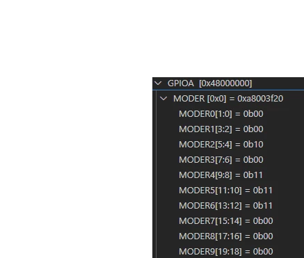

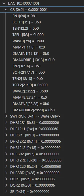

I feel rather stupid with this one since it should be fairly straight forward. I'm trying to use all three DAC outputs on the Nucleo32-F303K8 and I can get the first channel to work fine but I get nothing on the other channels. Multiplexing should be fine and I've removed the SB16 and 18 jumpers just in case but no dice.
I attached the registers if anyone has any ideas.
Thanks
//Henrik

In contrast to DAC1_OUT1 - DAC1_OUT2 and DAC2_OUT1 are unbuffered. This means, that you have to set BOFF bit for them, and also their output current is very limited.

According to the reference manual RM0316, in the STM32F303x6/8 and STM32F328, the DAC1 channel 1 comes with an output buffer.
The DAC1 channel2 does not have an output buffer, it has instead a switch allowing to connect the DAC1_OUT2 to the corresponding I/O (PA5). The switch can be enabled and disabled through the OUTEN2 bit in the DAC_CR register.
The DAC2 channel1 does not have an output buffer, it has instead a switch allowing to connect the DAC2_OUT1 to the corresponding I/O (PA6). The switch can be enabled and disabled through the OUTEN1 bit in the DAC_CR register.
Hope this helps!
Firas
